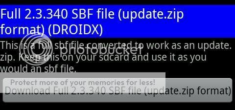

...I just looked into the 2 step gb process and it requires 2.3.340(which I assumed it would), but then I noticed a 2.3.340 SBF in update.zip format. Is this flashable through stock recovery without the need for a computer?

Sounds like you feel the same about it as I do. I just saw it on the TBH app. I understand what it says it does, but I've never heard of sbf via recovery/clockwork. Im about to try this. 340 sbf update.zip. I'll post here how it goes.

well you have now! I just flashed it and it took me from gb 2.3.3(4.5.596) to froyo 2.2.1(2.3.340)
you have to wipe EVERYTHING and also you have to use clockwork because it's not signed properly to be used with stock recovery. I renamed it to update.zip, wiped, and "apply sdcard:update.zip" in clockwork. It booted up first time!
successful firmware downgrade without the use of a pc!
i'm on the road to liberty v0.8 so once i was on 2.2.1 i rooted(z4), bootstrapped, and installed rm(just because). i am now flashing the 2 part update process to get me back to 2.3.3(.596 rooted) and hopefully my baseband will get updated along the way to 12
