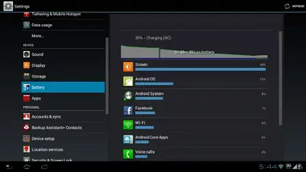

Why is there two android os. As you can see in picture?

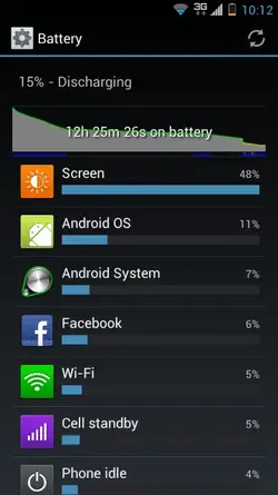

After doing a calibration of the battery. This is with moderate use and on 3g/wifi.
