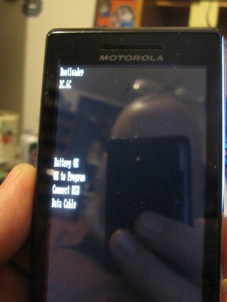

my motorola droid will not boot up. all i get on screen is...
bootloader
2c.6c
battery ok
ok to program
connect usb
data cable
any suggestions on how to fix. the phone is only about 6 weeks old. never been wet or dropped.
thanks
This is the screen I get when my USB cable is connected to my laptop when I tried to boot my DROID. I'm assuming your DROID is not connected to the USB cable. But perhaps there is something in the USB port that is shorting it out, or something. Try blowing in there and see if it'll boot then. Sounds weird I know ... it's all I can think of.

I have the same problem, every time i try to restart my Droid i get
Bootloader
2c,6c
battery ok
Ok to program
connect usb
data cable
The only way i have been able to get my phone to boot is to turn it off and on over and over until it finally completes the boot sequence. I really want better solution to this problem because it seems that i have to restart the thing pretty regularly because of other issues

I don't know how many people other than myself had this issue, but I was able to clear it up after tons of frustration. My error was slightly different (it said CODE CORRUPT under the boot loader numbers) but all that it needed to work again was:
1. Removing the battery and MicroSD card.
2. Replacing the battery after about a minute
3. Booting (past the error) and properly shutting the phone down from the menu.
4. Remove battery, replace MicroSD, replace battery, reboot and serve.
Boots and reboots fine for me now.

I just had this problem this morning, but mine was easily fixed. I pulled the battery and sd card, then replaced battery and booted it. Turned off phone and replaced my sd card and all was good!
