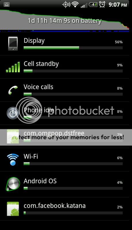

Update on my testing.....
Tried sleep mode last night and was able to save a lot of the battery....about 20-30% loss of battery within 10 hours of sleep mode so avg of 2-3%per hour which is not bad...
I do have 4G on at all times and I'm in a strong 4G hood lol...checked my task manager for the vampire app and its mostly screen time for majority of battery use....I initially had it on manual low light setting now ill try the auto....I did notice once I set it on auto that the capacitive buttons don't light on as much....
I'd say I'm milking at least 8-9 hours out of it with light use and the fact that it didn't die overnight was a big plus. Oh also with background data turned off it made a big enough difference.
