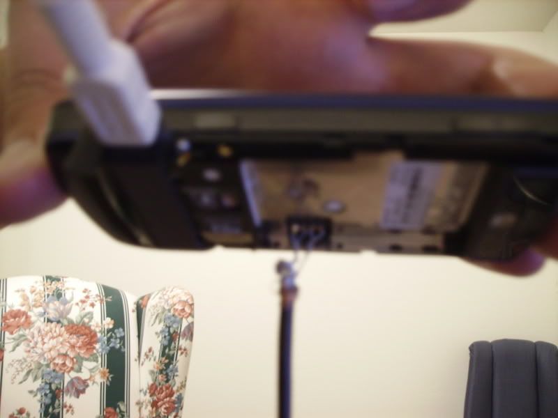

Once you are sure the wires are only touching the + & - contacts, pop the battery back into the phone. You should have something like this:
B. Remove the battery from you phone. Inside the battery compartment you will see the 4 contact pins. (the pins that have contact with the battery)
Take the red wire and thread or loop it around the pin furthest to the left making sure it only has contact with that pin.
Take the black wire and thread or loop it around the pin furthest to the right. Again making sure it only makes contact with its specified pin.
Once done you should have something like this:
(different phone, same process)
Now plug in the USB into the computer which should hopefully solve the battery problem.
Then plug the USB data cable to your computer and your phone.
Boot into the the bootloader and reflash or do whatever needs to be done.
Once all is done, make sure you unplug both USB cables prior to removing our make shift charge/bypass cable.
I hope this helps anyone having the Low battery cannot program issue!

I realize this is an old thread but I haven't seen anyone give a Thank You. So I say thank you humanio. I have had a number of bootloops but with this one the battery would not charge and and things were getting worse. There are other posts about this but for a guy like me the pictures made all the difference.
Interesting side affect. Once I had the wires in place and the bootloader was happily reporting a charged battery I went to start my sbf process. I then found out my sbf was not a full download. I started the download again and left the wires hooked up and went to the store. I came back over an hour later with the download finished but the phone wasn't responding. My first thought was "I fried my battery", or something worse the way things were going. It turns out that my battery was fully charged! Woohoo! I pulled the wires, put the phone back together the way Motorola had intended and had a lovely time with some sbf goodness.
Thanks Again.
This method worked for me. Only problem is, now my phone does not recognize my battery. It says "Invalid battery" and my battery charging icon has a question mark. At this point my phone shut down, ad when I reboot it I get stuck on the Moto Logo & then a battery icon with a question mark.

WORKS LIKE A CHARM!!! THANKS FOR REPOSTING THAT, MY GOOD MAN.dancedroiddancedroiddancedroid
When i do this, i just get my green charging LED, and a blank screen. I tried plugging both usb's into the wall, with two different USB wall adapters, and still i just get the green charging LED. Any ideas?
