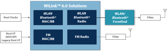

if anyone wants to work on it here is some more info on the chip that is in the phone
apparently the chip also supports N networking but wasn't written in the code.
Mobile Wireless LAN - WiLink™ 6.0 Solutions
Wireless Connectivity Solutions - DRP™ Technology

Exactly, it's built into it. This means that the manufacturer planned for it to have FM from the beginning so they designed it with an FM radio (think antenna... a physical item built into the phone) which means that it has an internal antenna tuned to the proper frequency for FM reception. Without an antenna it's going to be quite difficult to add after the fact. Just like your phone can't control your TV w/o an IR emitter. Just like you can't control your garage door w/o the proper radio for your garage door receivers. All of the above can be done with the internet and proper hardware but just to have the phone do it on it's own w/o the proper hardware to support it isn't just a software fix.

its built into it the same way its built into the droid... the hardware is there and should work in theory but for some reason it was never enabled from the manufacturer. A developer managed to find a way and write the code to enable it in a custom kernel.
