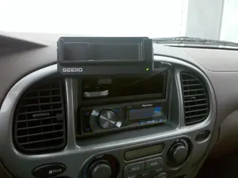

I also decided pretty early in my planning that I didn't want to use the 3.5mm audio jack on the phone. I have a Seidio car dock that I can slide the phone in to easily with one hand to charge it, and reaching over to plug in an additional cord was just one extra step I wanted to avoid. I hoped to be able to pull the audio from the USB port, like many phones are able to do, but with the Droid it's just not possible. So I needed to use Bluetooth.

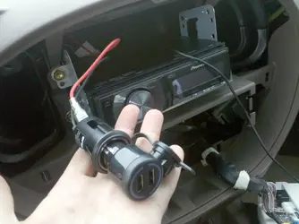

The biggest gotcha with my setup is that the Blackberry Bluetooth Gateway uses a USB charger (not included) for power. This means 1) you'll need to buy one and 2) you'll need to have 2 cigarette lighters in your car to power both the gateway and your Droid charger.
In my case, I have an old power adapter that I've torn apart and wired directly to the harness for my stereo. My main reason was to keep everything as hidden as possible, but it has the added benefit of not using up my lighter ports.

OK, I started putting everything together tonight but it turns out the DC adapter I bought off eBay was junk. I'll need to get another one and try later.

Yeah, I decided early if I didn't have a charging dock, this wasn't an option at all. I did get it set up but not wired yet - the dual USB charger I had was junk. http://www.droidforums.net/forum/droid-accessories/22583-my-car-dock.html
The pairing thing was another no go, which is why I ordered the Blackberry BT gateway. Just crossed my fingers hoping it would autoconnect, and it worked out.
I'm looking for a right angled mini-usb (not micro) that I can connect to my Seidio dock, anyone know a source? The only thing I've found that is angled the right way is this: http://www.gpsdeals4u.com/gps-Gilss...ht-Angle-MiniUSB-Connector--GIL-GUSB-110.html Too much money and I'd have to hack it up to connect it to my cigarette lighter adapter.
