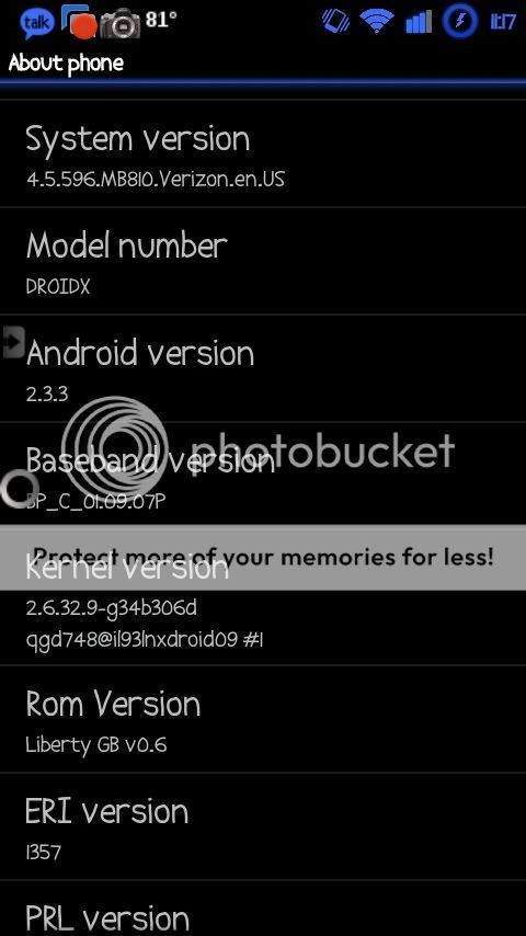

I am not sure this is a bug, but my baseband isn't updated... it is still reading 07 & not 12... is there a patch fix?

If u didn't install the the 3 file. 588 version before u went to the newer version then that's prob why ur not on 12. And ur supposed to have 12 before flashing .596, hope that helps

I have the same "problem" here. It is probably because I did not install the mysterious 588 3 part zip. (It is not in the TBH Rom manager). Not sure what the fix is. Also, my kernel says #1, as does yours.
No...the directions say in big red letters that if you're not on radio .12 then you need to sbf back to froyo .340 and use the two part method #2.
