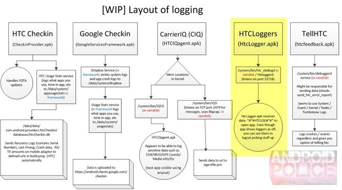

In addition to Carrier IQ (CIQ) that was planted by HTC/Sprint and prompted all kinds of questions a while ago, HTC also included another app called HtcLoggers.apk. This app is capable of collecting all kinds of data, as I mentioned above, and then... provide it to anyone who asks for it by opening a local port. Yup, not just HTC, but anyone who connects to it, which happens to be any app with the INTERNET permission. Ironically, because a given app has the INTERNET permission, it can also send all the data off to a remote

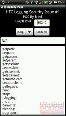

In fact, HtcLogger has a whole interface which accepts a variety of commands (such as the handy:help: that shows all available commands). Oh yeah - and no login/password are required to access said interface.
Furthermore, it's worth noting that HtcLogger tries to use root to dump even more data, such as WiMax state, and may attempt to run something called htcserviced - at least this code is present in the source:
/system/xbin/su 0 /data/data/com.htc.loggers/bin/htcserviced
HtcLoggers is only one of the services that is collecting data, and we haven't even gotten to the bottom of what else it can do, let alone what the other services are capable of doing. But hey - I think you'll agree that this is already more than enough.

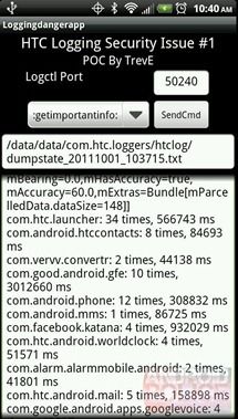

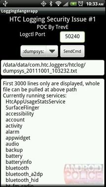

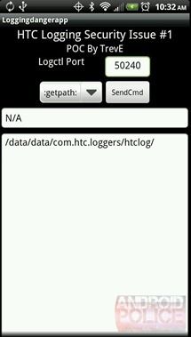

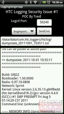

Proof Of Concept App

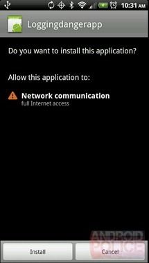

In order to help showcase his findings, TrevE created an open-sourced POC (proof of concept) of a simple app that requests a single INTERNET permission, then shows that it can gain access to all the data I mentioned above. I ran the app on an unrooted EVO 3D - see the screenshots below or try it out yourself.
There is also a video walkthrough below the screenshots, shot by Trevor himself.
server
, killing 2 birds with one stone permission.In fact, HtcLogger has a whole interface which accepts a variety of commands (such as the handy:help: that shows all available commands). Oh yeah - and no login/password are required to access said interface.
