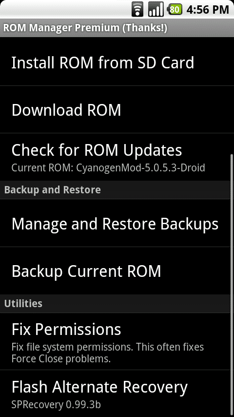

I am running clockwork. But before I did. I used droidmod to install my nandroid back up and sprecovery for me. Then From their I installed rom manager. Flashed clockwork recovery, backed up current rom, downloaded rom clockwork 5.0.5.

Now i got it into clockwork once i updated to the latest RM and clockwork 1.1.7.8.4, but now when it reboots into clockwork it ends up aborting due to error in /sdcard/clockworkmod/download/koush.romraid.com/motorola/sholes/cyanogen_ota_eng.koush_5.0.5.3.zip
any ideas? should i remove this file from sd card and try to reinstall it within RM?
btw, when i reboot from clockwork it makes me do the google sign in to sync. but i find it weird some of my apps are still there after this whole mess.
the cyanogen file is 69.2 MB in size. does that look right?
i rooted via dmupdater. i dont have sprecovery. just clockwork.
