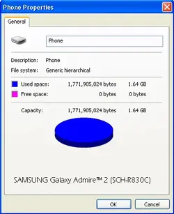

Uninstalling apps to install others will not work. This happened with the old 2GB card because it was really full. But then I could uninstall and install other apps.
It says it has 25GB's free memory, but won't work.

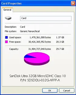

When the new card arrived, I copied everything on the card to my PC then to his new card after formatting it in the phone.

Here is the Card's Properties via XP.
This is the Phones Properties via XP.
