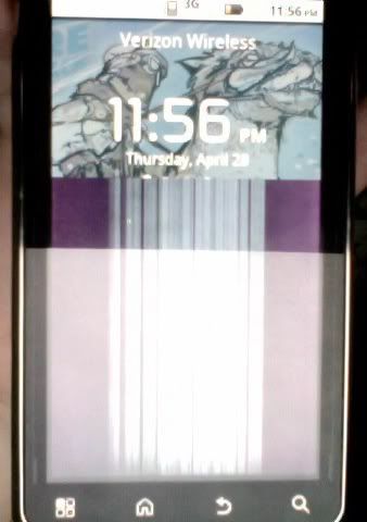

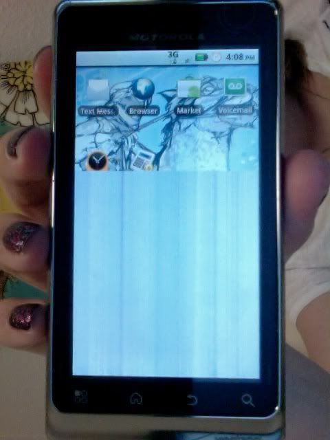

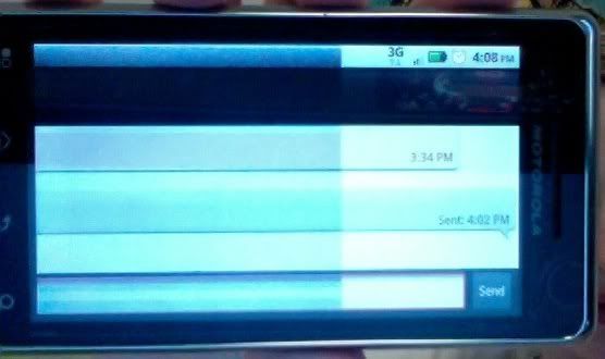

Last night 3/4 of my screen starting doing this, the buttons are still functional, I just can't see anything..nothing helps and I've tried everything! I haven't dropped my phone at all, I have no idea why its doing this. I went to the Verizon store today, the guy couldn't tell me anything and just said I needed a new phone. I wanted them to replace it, but due do a (microscopic) scratch on the side they won't..I have to go through insurance. Can someone please tell me whats even wrong with it so i can see if the problem can be fixed for cheaper than getting a brand new phone!
Never seen anything like that before. Hate to say it but I think a new phones your only option. I think you happen to get a lemon and something in the display has broken.
When you reboot do you see the same situation? The M logo tearing and the bootanimation tearing?
I would imagine you do, but if you don't it might need a factory reset or an sbf.
If M logo and such are tearing, it is probably the digitizer, which you can replace if you are handy with soldering and taking phones apart. Otherwise, a new phone is in order.

Yeah the screen splits the second I turn it on...is there anywhere I could take it to get fixed do you think? Verizon won't do anything at all, and they want to send me a new (more like referbed) phone for $100..I really rather not have to pay that considering haven't done anything to the phone :icon_ nono2: I've barely had this phone over a month.

That's likely a hardware failure and probably couldn't be fixed through SBF. How long have you had your D2? VZW has their own 30-day replacement period, but the D2 itself should have a 1 year warranty from Motorola - if it dies in that period, you should get a replacement device through VZW at no charge (though it will be a "factory refurbished" one, not a new one). Any VZW store should help you out.
