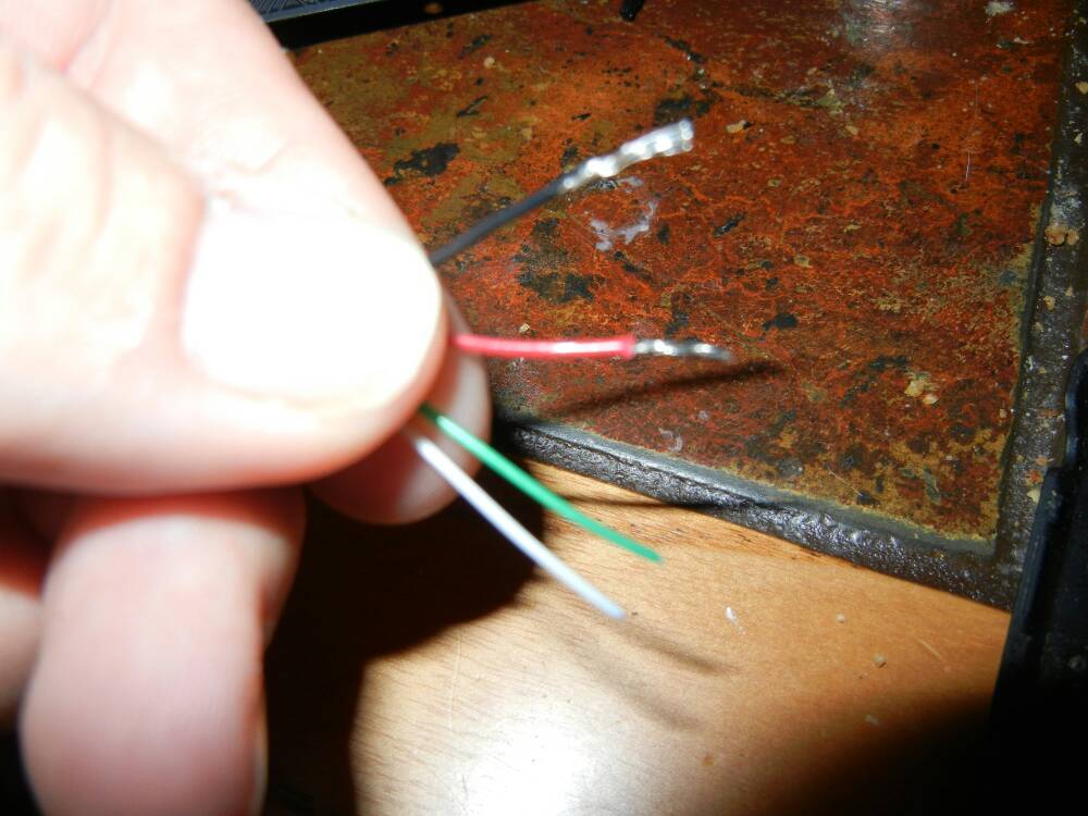

Obsidian...
May 19, 2012
108
3
Here's a couple pics of my phone when I did it a year ago
