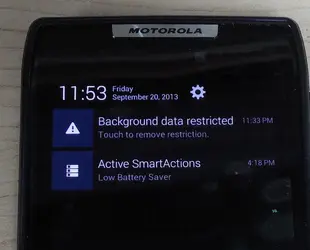

One thing I noticed was all the ones that drain faster have two messages when I the home scree and swipe my finger down from the top it says "background data restricted" touch to remove the restriction. Then it also says active smart actions, low battery saver.
The three phones that have 50% battery remaining after 48 hours does not have any messages when I swipe my finger down the screen. So that may have something to do with it, does anyone have any idea? below is a photo of the two messages that show up on one of the four that only last 48 hrs.
