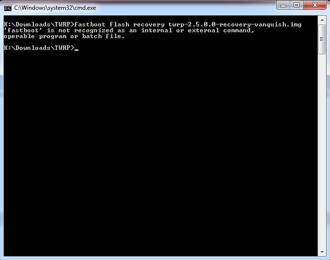

Ok so now I have a new problem. I'm apparently missing the "fastboot" program or whatever it is, because it doesn't recognize the command when I type into the command prompt.
Guessing this is an obvious fix, but what am I missing? lol
EDIT: I found the following link to install fastboot (along with a few other tools) and it seems to have fixed my problem. I appreciate your help DroidModderX
http://dottech.org/21534/how-to-ins...ows-computer-for-use-with-your-android-phone/
