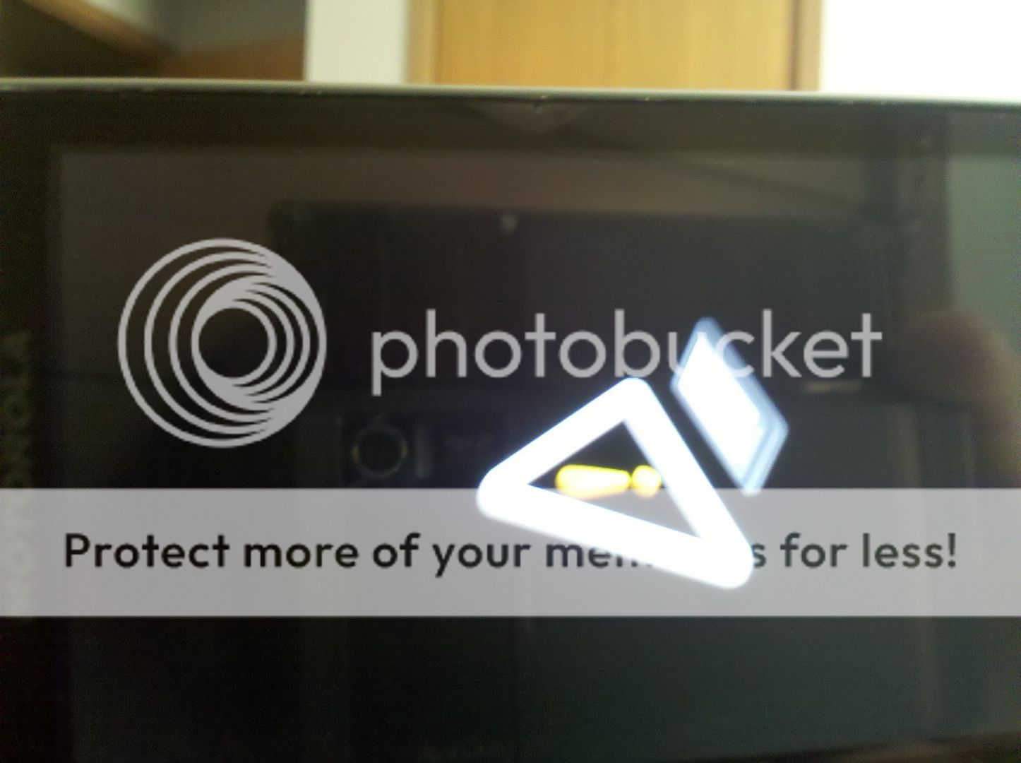

Today while not using the phone, it suddenly reset in my lap and started looping in a "charging red-eye" screen. (would loop that and the DROID logo)
I have tried booting while holding x + power (which I have to remove the battery, hold the buttons, then insert the battery while holding to accomplish,) but even after it gets into the "Triangle + ! and Cell Phone laying down" screen, nothing happens from there... it appears frozen.
I would also like to mention that the Triangle + ! screen is the only thing that will work (have tried volume, etc.)
Any help would be much appreciated, and I am definitely willing to try what you all have to offer.

Ahah! Volume up + camera button I see!
Have now cleared the cache and reset the baseband data (not sure what this is.)
Did a full hard (or cold) reset from that menu as well, and I am still sitting at the "charging eye" loop.
Actually, the loop has now ended and the phone now boots!

In that same menu do a factory data reset should clear that bootloop up
