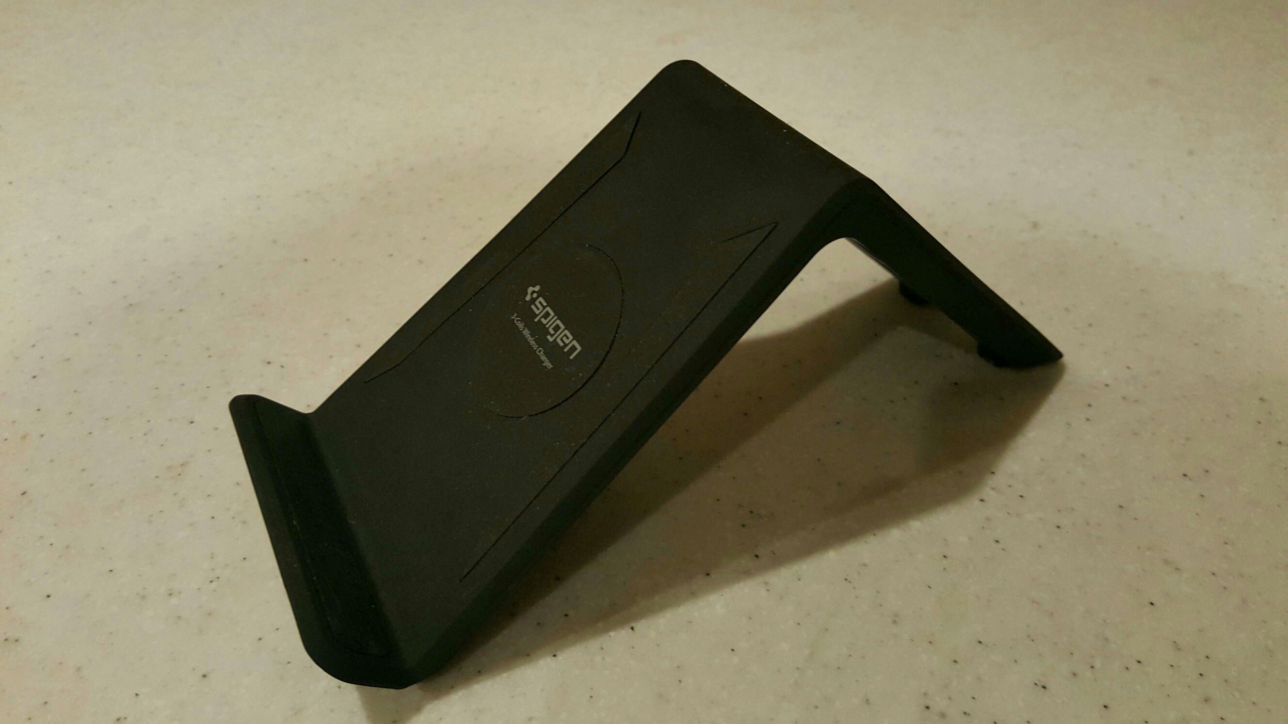

I have an after market wireless charger, it's not a disc but a stand. The phone can be placed vertical or horizontal and it's not very picky about placement. I used the fast charger that came with my phone and it works very well.
It's made by Spigen and fairly cheap at Amazon.
Sent from my SM-N920T using Tapatalk
Spigen is good stuff, plus that one is a 3 coil unit, so yeah placement should be a breeze. Might order one of those for my work.
