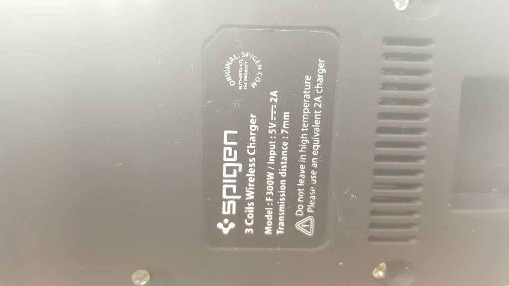

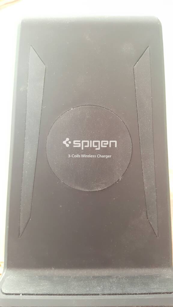

Here's my wireless charger.
Spigen 3-coil

I initially had an issue with my Samsung Charger. I'd put it to charge wirelessly, but then it would saying Charging Paused.
It appears that the workaround was going to Settings > Display > Daydream
Turn Daydream settings to On and also make sure the Daydream settings were set to While Charging.

This is probably obvious, but what is daydream? I've tried out on my Note 3&5 and I don't get it.
Sent from my SM-N920T using Tapatalk
It's like a setting that prevents your phone from going completely off or completely to sleep. Kind of like a stand by feature that let's it keep charging.
Not sure why, but it fixed my Charging Paused issue.

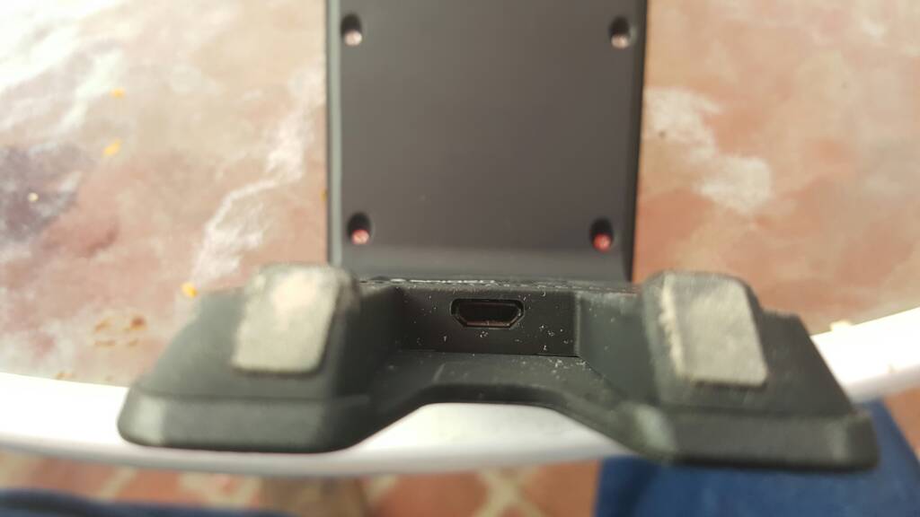

I have the Samsung Wireless Charger Model # EP-PG920I. I got this one Free when I purchased my Note 5. I have Noticed that same Flashing LED while supposedly Charging. This isn't the first time this has happened to me with a Wireless Charger. I have had this happen with my Incipio Ghost 100 with my Droid Turbo. I wonder if it has anything to do with the amount of Coils it has and being slight off target. It may be enough to start charging but then causes too much drain with not enough contact and then stops or maybe it is getting to HOT. Next time this happens I will check the Battery Temp. I have to say that it will charge my Note 5 to 100% so I haven't had that Issue but I have had that Issue with the 2 Chargers I own. I have another one on the way like the Samsung one but I bet it will be the same.
So the white Sammy quick charger you have works just fine?
I should exchange mine with the white one to see if that's what the problem is.
Yeah it works fine, but I've just realized it does not fast charge on the wireless. If I plug it on directly it will charge up about 30% in 15 minutes.
