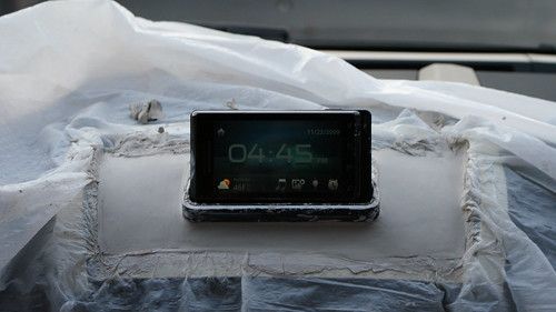

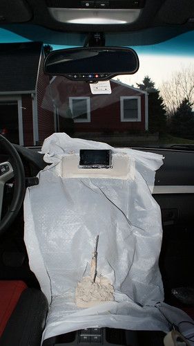

I have integrated the multimedia dock into my car's dash (reversed the magnet so that it opens the Car Home instead).
Pics or it didn't happen.
Just because I didn't post pics doesn't mean it didn't happen....
The only pics I have right now are old and are of the plug. It is now sanded, prepped, and ready for glass.
Right now I am just using the model (its wired up with power only) until I lay it up in fiberglass -- hopefully Wednesday morning (if you are actually interested I will post the pics of the process and final product). I am just waiting for my resin to arrive. The 12V harness is wired to a DC/DC Micro USB Car Adapter with an audio cable going to the rear aux of the head unit (which is still disconnected).
The final product should look clean. The glass will be sanded down to a matte finish, and sealed with a matte resin coat.
I also rigged it up to remote start it via the Droid as well (right now its just using HTML code to run a WebRelay, but I am looking to make a simple app). I just need to get my hands on an old laptop with PCMCIA II slot to activate my broadband card (the car also has wifi). I suppose you will want pics of that too... I'll post a video once it is cleanly integrated. Right now its just a mess of cables and hardware as I have been too busy to integrate it. I figured as long as I had mobile WiFi , I might as well give it a cellular remote start -- for $hits and Giggles of course.
But back to the original question... Can the damn thing pump audio via USB. If it can't I am just going to use a BT Audio Gateway (which is a whole 'nother question)
