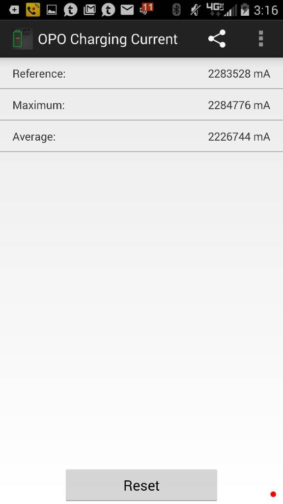

Below is a reading from opo with my phone on Turbo Charging while at 60%.
It clearly shows at least 2.2 amps going to the battery.

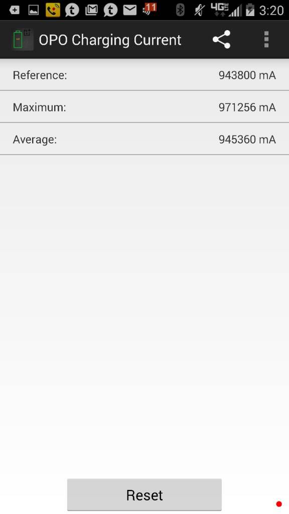

And here's the same app reading while charging from my 10K portable battery on the 1.1 amp port.

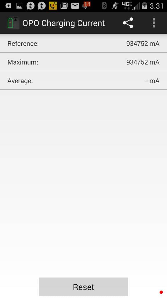

What's strange is that the following is a reading from the same portable charger but in the 2.2 amp port, and its actually lower... I'm also not getting an average on the 2.2 side and the levels are bouncing all over the range from zero to the max.
I'm beginning to believe the 2.2 amp side of the charger is either defective or the phone is simply working hard to curtail the current rate to protect the battery.
Maybe they meant microAmps, not milliAmps (mA), in the app display.
Because 2226744mA is 2226A, I think.
