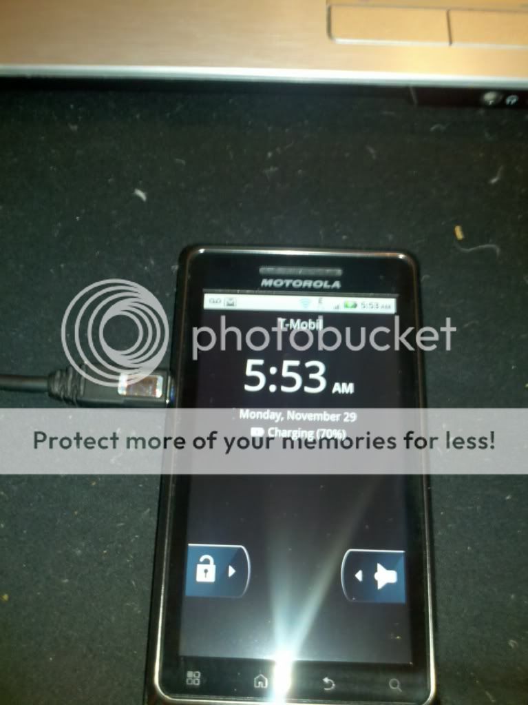

It has been done on consumer hardware...he wasn't "frauding".
Given the extremely valuable nature of this hack, I think it's very likely to be made available as a fee service.
My source said it is virtually impossible to figure out how to do without inside knowledge of proprietary code.
I am courious why the screenshot says "T-Mobil" and not "T-Mobile"?
