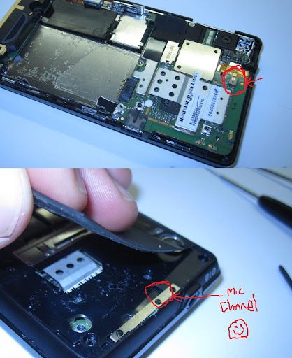

because the bottom is part of the main chassis. ive had my droid apart already, all that's good for is disassembly, there is nothing underneath it. that rubber bumper is just a sticker
unfortunatly i think these images prove you wrong....here the 2nd mic
