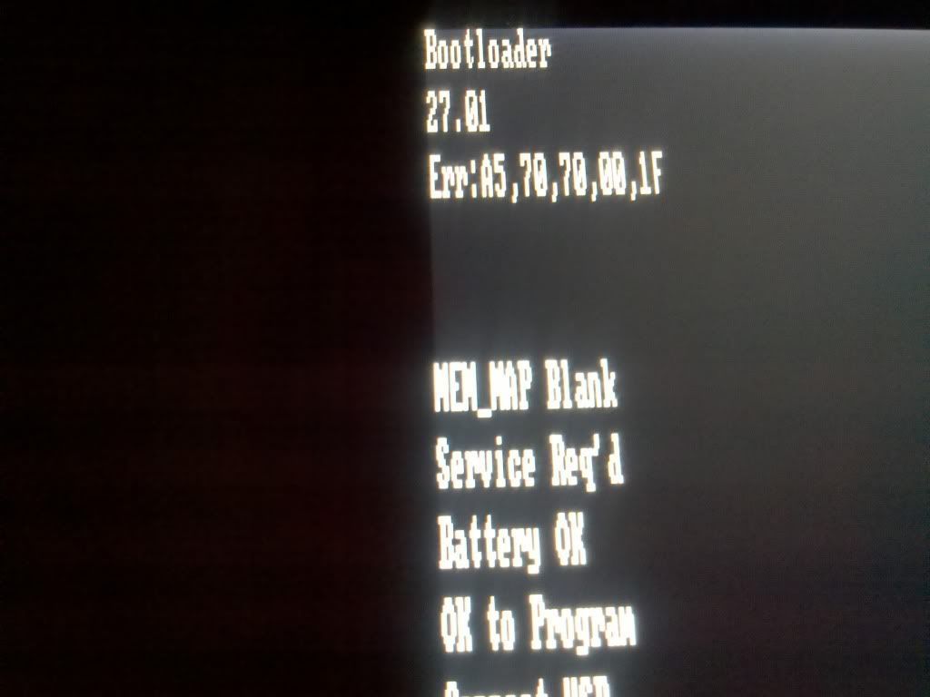

Same issue, Another Person Here.
"Bootloader
30.03
Err: A5,70,70,00,00
Mem_Map Blank
Service Req'd
Low Battery
Cannot Program
Still with bootloader 30.03 did not downgrade to 27.01.

You guys have probably already figured this out, but they changed the signatures in everything from mbmloader forward. All your old code groups are useless now for going backwards. They were serious about this. Kudos to them for a clever chess move.
