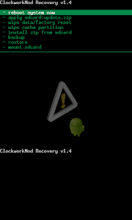

so if you did not manually go into here:
and scroll down to install rom then there is no other way other than rom manager to flash a rom period.
