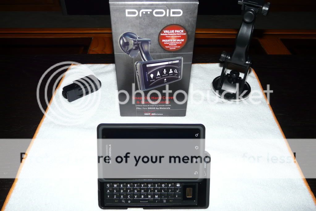

A Definitive Review: Snap-On Hard Cover & Mount Combo....MSRP: $29.99
*Available at your local VZN Wireless Corporate Retail Store..
*Hard Cover and mount is said to be compatible with all CoatCaseDuo Hard Covers.

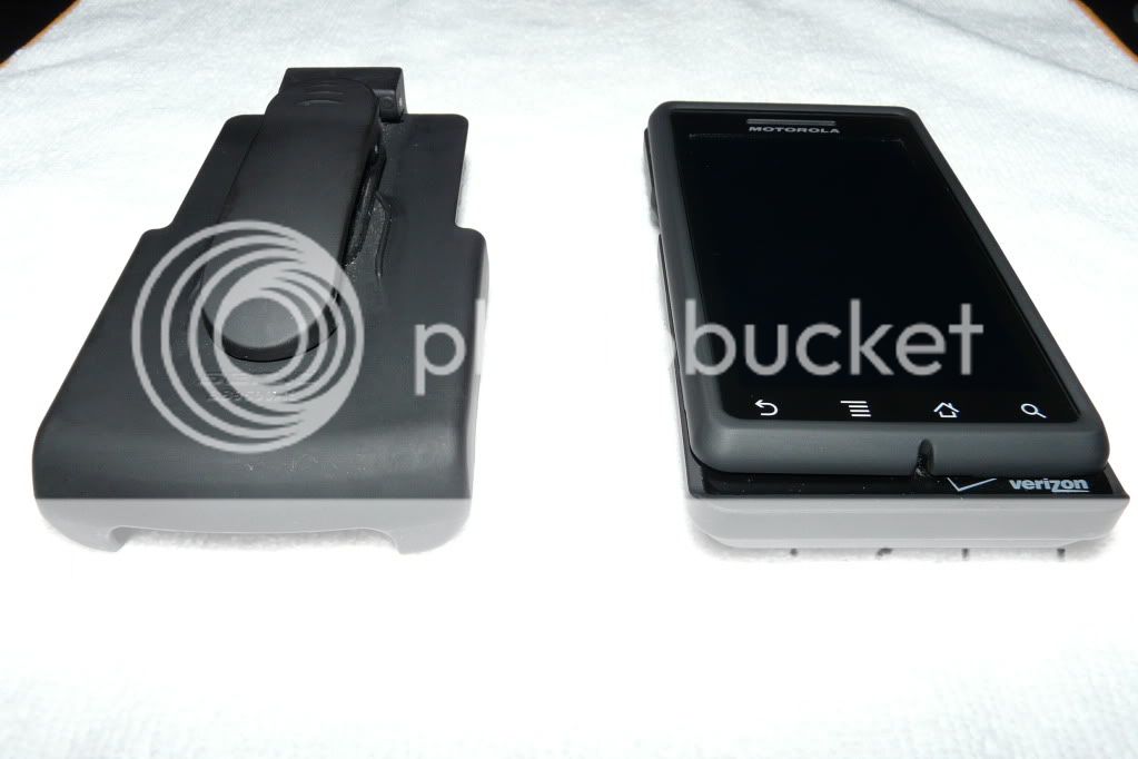

This set not only includes a Seidio Online-esque soft/hardened rubber 2 piece
case (which seems to be of high quality similar to the Seidio cases I've used and purchased in the past for other devices SHOWN HERE)
but.....it also includes a Suction-Cup Car Dock....The issue (that we'll handily solve in the last part of the review)
is that it does NOT come with any magnets which as you know enables "Car Dock Mode" to instantiate upon magnetic polarity recognition...

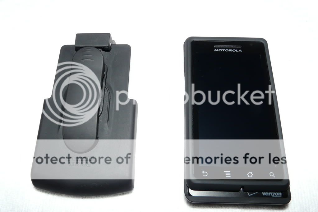

Verizon has also included a durable belt clip as well (as shown in the first picture)
which is branded with big Red's name and logo, imagine that!

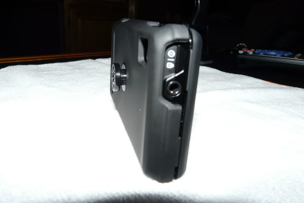

Fit And Finish:
Quality and Quantity at last merry happily with this unobtrusive design and ease of functionality!
Each piece (there are 2) snap into place as if they were meant to by some cosmic force, and I'm not kidding.
The fitment is unlike many cases I've purchased where something just didn't feel/fit correctly. Not a problem with this case at all.....
Another unknown little tidbit is that the top portion of the case (when attached of course) creates a firmness I haven't had the pleasure
of knowing before I bought this case. What this top piece does is add rigidity to the bottom portion of the screen (in landscape mode)

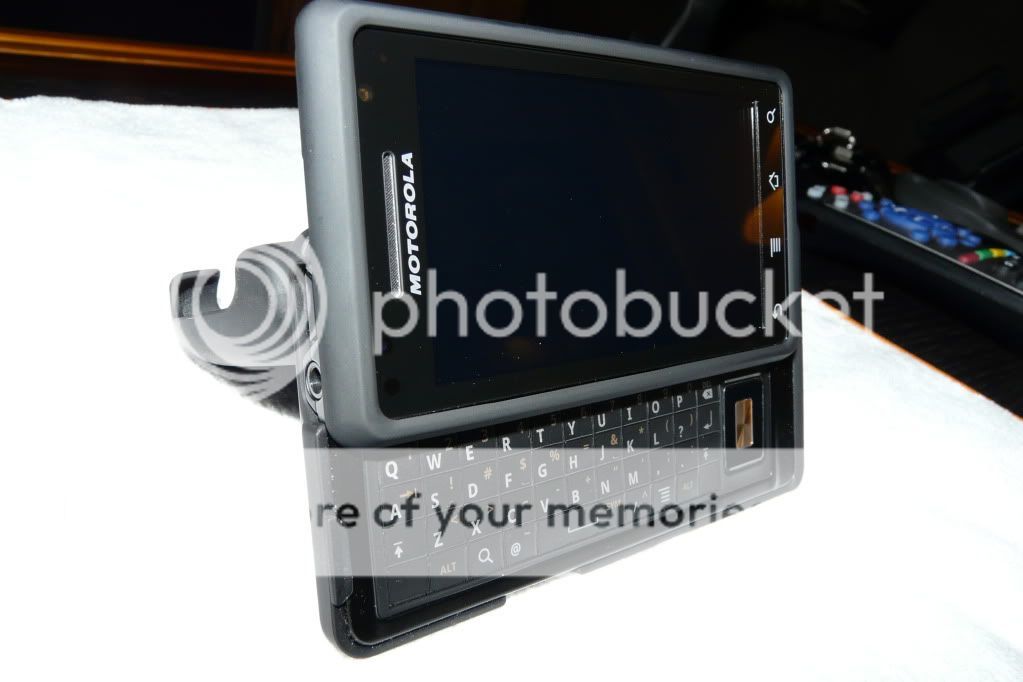

Some of you hear a faint thud when tapping the aforementioned side (back button section) This case eliminates this thud...Sweet!
I found texting via the slide out keyboard of the same Droidful, I mean dreadful uselessness I've had without the case!

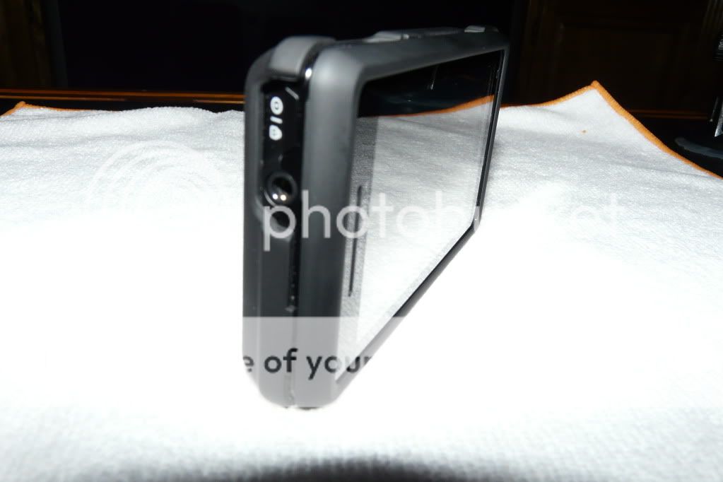

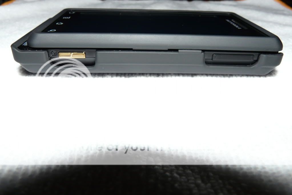

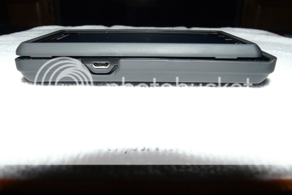

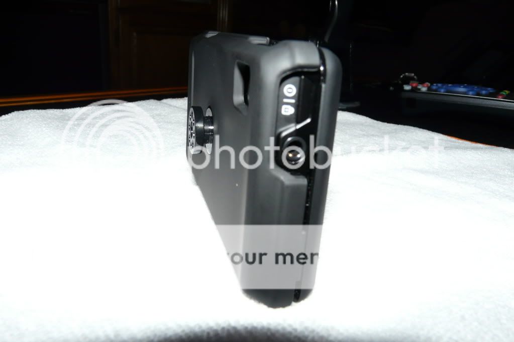

-With precise access to your:
-Headphone Jack/Sleep/Power Button
-Camera Button/Camera Lens
-Micro USB Port
-Volume Buttons
-Microphone, and most importantly:
-The speakerphone housing!
-Call quality and alerts will ring through and will not be muffled one bit.

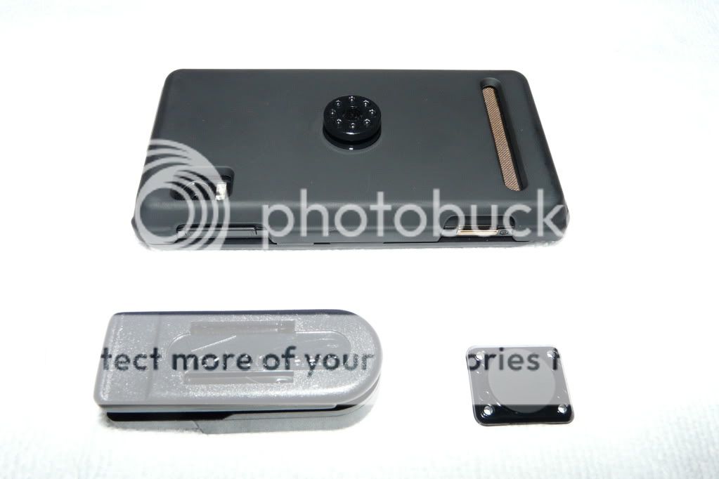

*In order to use the dock you just purchased (with the 2piece case), a circular connector must be added to your case---which mounts on the back securely. (I call it the Droid Dock Connector or DDC)
It cannot be removed without taking off the back portion of the case.
Taking off either piece can be a real PITA. The teeth
(from either piece of the case) that grab on to your Droid *may*
need some sanding IF you frequently take off the cover, just an FYI...
The only other negative I can make it worth mentioning is Fingerprints! Doh!
If you have sweaty hands/palms or are just 100% nervous all of the time you will see them show on this case...
I would invest in a micro fiber nappy. I use one and it cleans as it wipes!

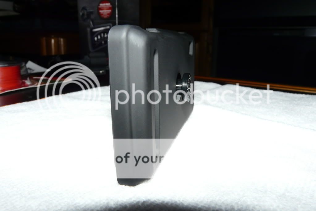

How Thick Is It?
I must admit I dislike cases that make an already brick looking device even thicker
but this case really is thin! From the Droid's back side to outer most edge of the case it's about 3/8's of an inch,
and another 3/8's of an inch from that to the Dock connector. Not bad, but not great either...
As for the top piece?
You hardly know it's there, and does a great job protecting your investment.

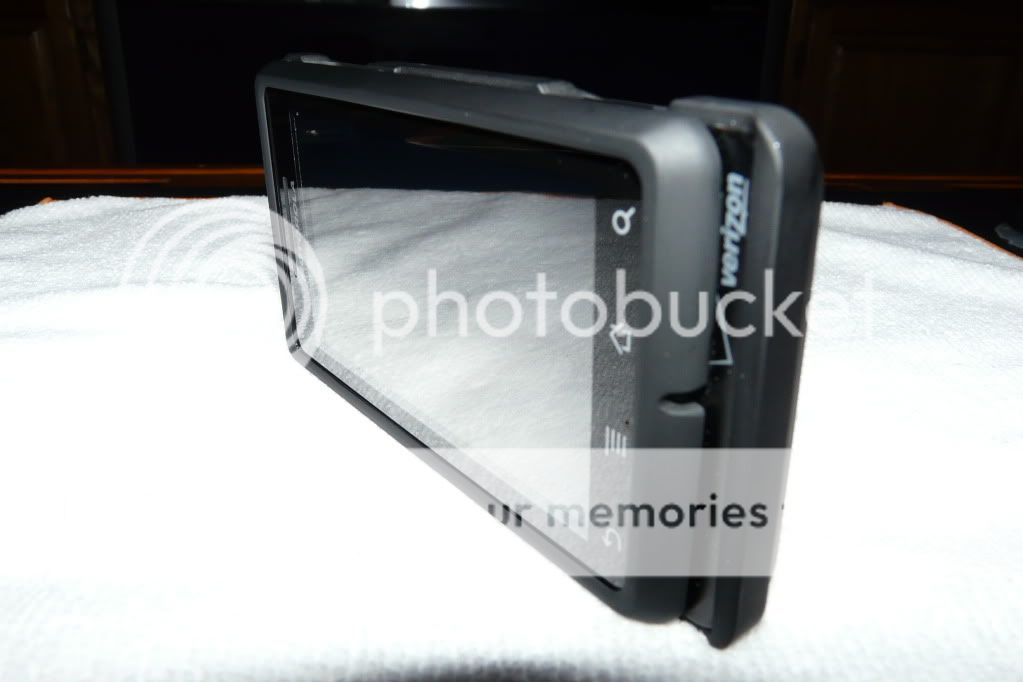

Form And Function:

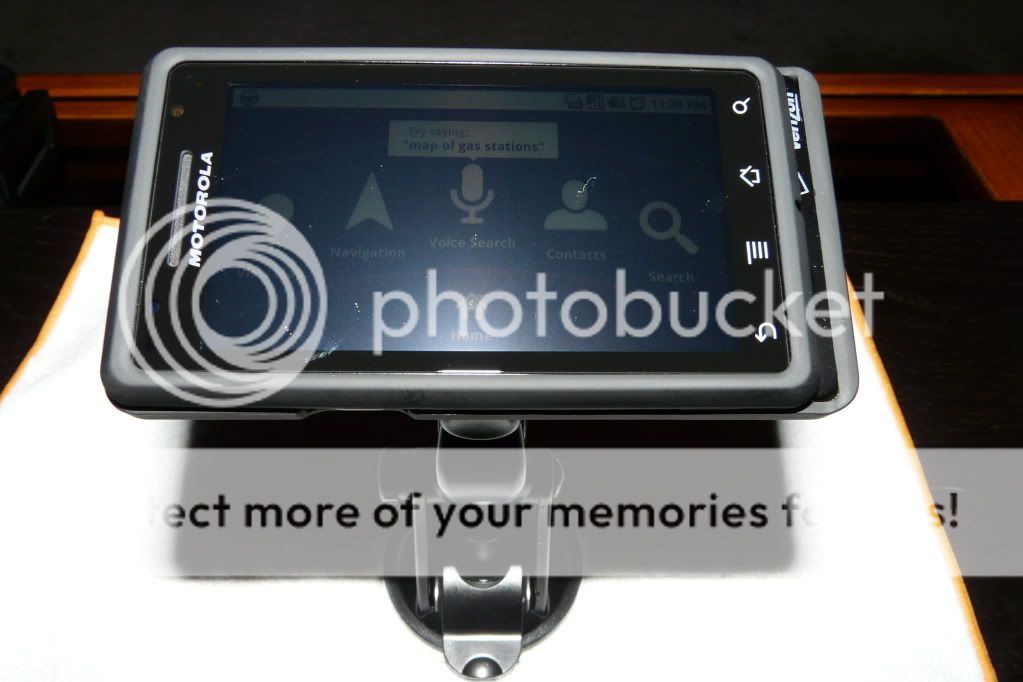

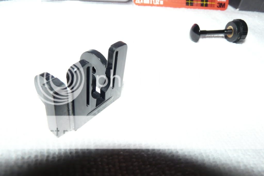

Docking the case has never been easier thanks to the well thought out connector
(or hindrance) depending on how you look at it. On one hand the connector
which Docks your Droid to the Car Dock snaps into place, AND utilizes
*teeth* which are arrayed in a circle to allow up to 360 degree placement!

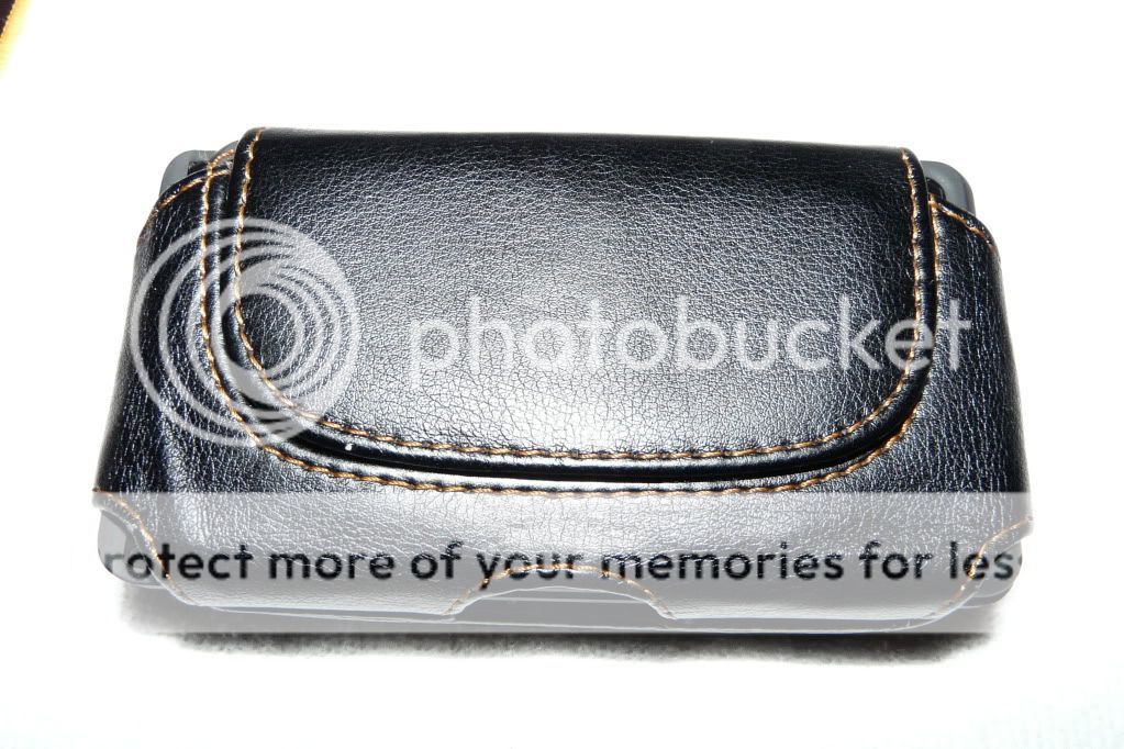

However...on the other hand having that Dock connector
(which comes out less than a 1/2 inch) protrude can hinder your Droids ability
to be housed inside of a leather holster or pouch.

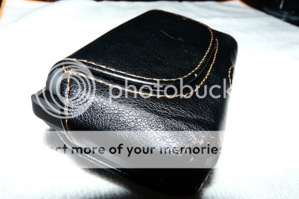

As an example here is my leather holster while being a tighter fit than usual does
hold my Droid nice and snug without having to ram the crap out of it in order to fit.
YMMV in this regard. This case was purchased via Slickdeals.net all for a whopping .99 cents FS!

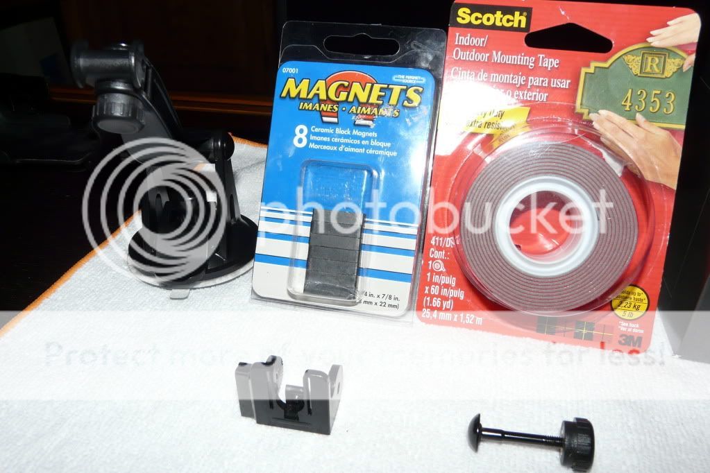

*What you will need*
1.) Access to Home Depot
2.) 3M Double Sided Tape (Red Package) UPC:021200471032 Price: $4.97
3.) The elongated 8pack of magnets............UPC:095421070015 Price: $1.98

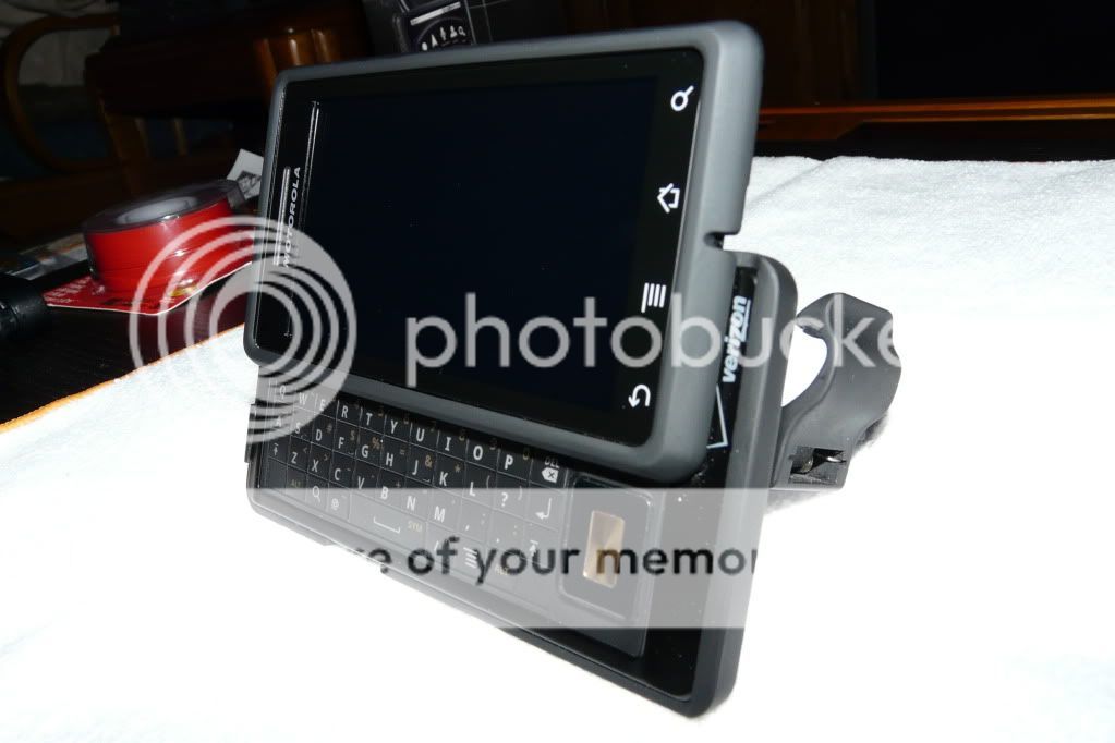

Once you have all three items covered take off the plastic piece that holds your Droid Dock Connector (DDC) by unscrewing it. Look Here:
Once you've done this take (2) two magnets...
Put them together so that they act as one bigger magnet.
(Pro Tip: They already come stacked together correctly, so just grab two, and keep them together)
You don't really need 2 but it makes everything easier to do.
Once the tape has bonded with both the plastic and the magnet I took the other magnet off....

What you want is the widest most area of the magnet adhering to the LEFT
side of the plastic piece which houses/holds/secures the DDC
(Droid Dock Connector...Look at the previous picture to be sure)

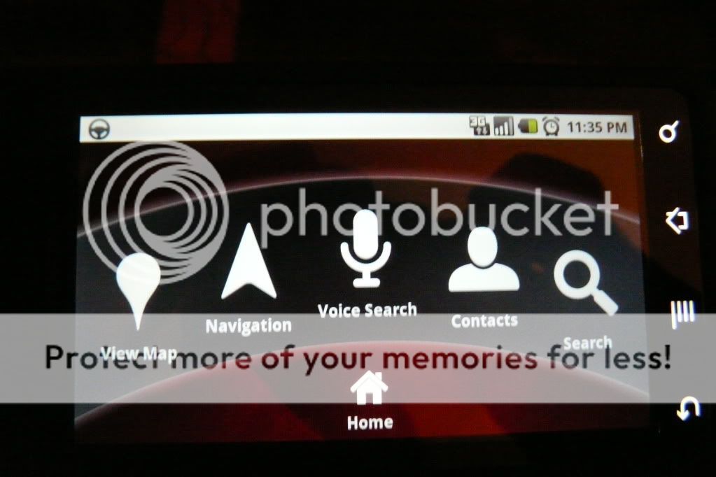

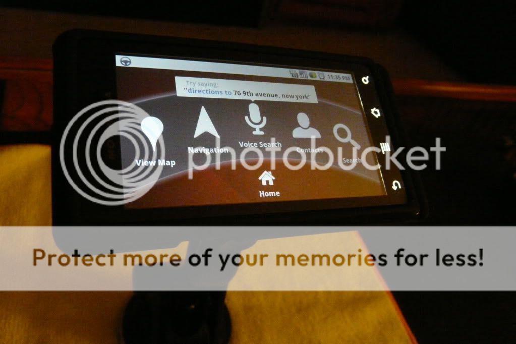

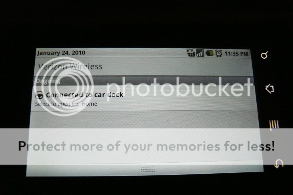

Putting the magnet with correct polarity and placement will activate Car Dock Mode...
Once you have tested the magnet by putting the correct side onto

Here is the picture again:
PLEASE NOTE:
Directions come with this Car Dock so make sure you have the Car Dock, and plastic piece positioned
in the correct direction. Remember, There is only 1.
Once the light brown side is secured and essentially glued...carefully take off
the red side of the tape...
Put the right side of the magnet (the side with the widest width) and adhere it to the
light brown exposed tape (making certain the polarity you've just tested IS the same when you
bond the magnet to the light brown exposed tape....BUT be sure to position the magnet just below about a mm,
so that when the Droid is docked...it does not hit the magnet. Play with the fitment/magnet's position before bonding.
Look at the picture for confirmation and hold tight enough to bond, but not too tight to break the plastic because it is plastic.
If you've done everything correctly...
Your Droid Car Dock should now look like this:
Enjoy your newly Car Dock Activated Car Dock!:icon_ banana:

I don't like the DDC either that sticks out...but since I have a leather case
and it fits...I can live with it... I may try and make a magnet mount...since there is
that 3/8's of clearance under the case (between the case and Droid) I could put one there, and one on the plastic piece....It should work.
As far as my screen being scratched the leather holster protects it.

Yeah, I can see that. I don't use the belt clip at all, and the leather pouch I use protects everything perfectly.
-Second, the hard cover has a thin layer of plastic or tape over it that scratches very easily. I got my first scratch just sitting down in my car and it bumping up against the seat belt latch. Now with random nicks here and there, the whole cover looks like a snake shedding its skin.
I haven't noticed any scratches, but if I did have a belt clip...I wouldn't wear it while
sitting in the car, I've broken/scratched many cases this way...
Aside from that, it's a pretty good kit for a pretty good price and it does, in fact, protect the phone very well, just wish the case had a better outer layer so it didn't look so bad.
