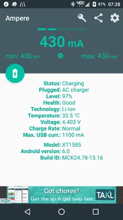

I checked Ampere before I turned everything off and looks like it was charging fine.
Why is WiFi displaying as steady On in your battery meter screen shot, if you were driving? I wonder if having WiFi constantly turned On is killing your battery. Some Turbo 2 Users (including myself) have experienced some Bluetooth & WiFi battery drain ever since the Marhsmallow update. Mine is not severe, but Bluetooth uses more battery than it did on Lollipop and keeps my phone awake sometimes even after disconnecting the device. Some Users have reported drastic battery drain with WiFi, Bluetooth or both. I wonder if that is what you are experiencing?
I wonder if I turn off WiFi for a couple of days, that might tell me something. I have no idea why it was "on" while driving -- unless the NSA is hovering over me on my commute ;)
I'm going to turn off WiFi, charge up my phone to 100% and see what the rest of the day and my commute home tonight show...
