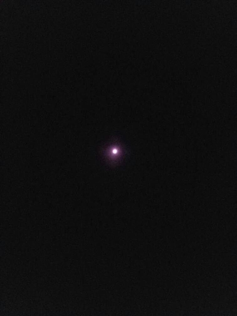

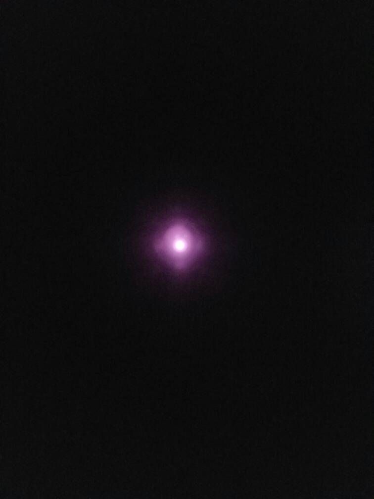

To clarify things, here is a pic that you can plainly see that it is not the LED light that everyone assumes. Auto brightness is OFF, S beam and NFC are both off and Face detection is also OFF. It can only be seen while taking a pic or video of the screen with another phone. That's how it was discovered. So no, it is not the LED.

This is an old thread being resurrected. Reflection from the flash? If is only seen when a picture is taken, I assume it has to be associated with light reflecting on the sensor. (In your case)
And since you can't see it otherwise, I wouldn't worry about it. There's nothing nefarious going on here. [emoji6]

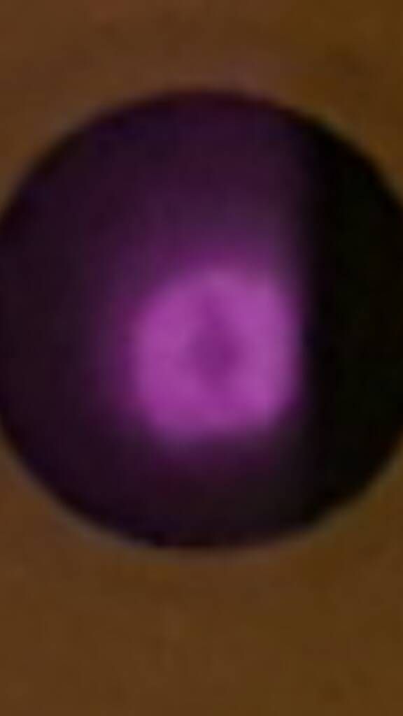

Not to disagree with you both, but the light seen in the pic IS radiating from the chip in the diode. Tiny diodes of the type seen in these phones have a tiny square or round chip and then there is an extremely thin wire that connects to the top of that chip in the center. It is seen here as a dark spot in the center of the light, and you can even see the fine shadow of the wire heading toward the top (see below).

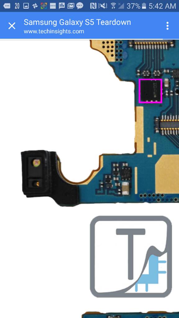

This is an infrared LED emitter that is used in conjunction with an infrared detector next to it in order to sense reflection of the light and to determine proximity of something as it nears the face of the phone. It could be to detect hand movements or to determine if the phone is in a pocket. See the two images below of the motherboard and of both the emitter, the smaller one to the left (bottom in the pic), and the detector located on the board to the right of the speaker.

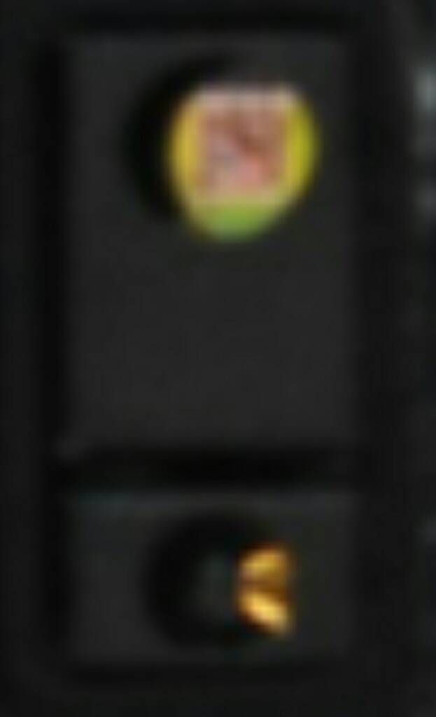

Here's a better pic of a combination device designed for the same purpose in an S6.
Since infrared light is invisible to the naked human eye it doesn't appear lit to us, however digital cameras, including those in our phones can detect infrared light. To prevent that light from interfering with visible light photography these cameras have an infrared filter in front of the sensor. However even with that filter some near infrared light manages to skip through and the sensor sees it as violet in color.

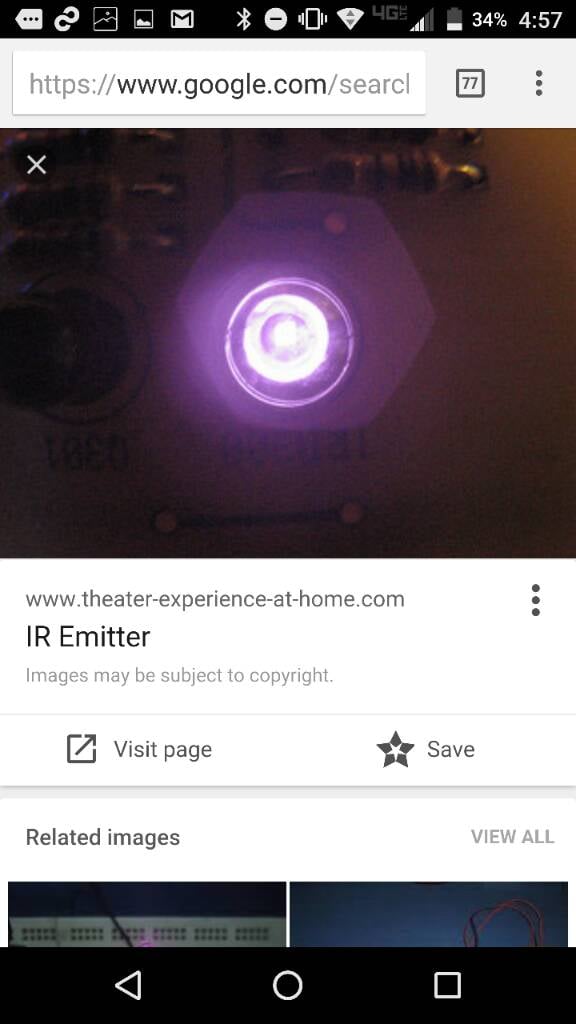

Here's another image found on a Google search for infrared emitter in photo.
This one is much brighter than the one in the OP picture, but those used in conjunction with a proximity sensor on phones don't need to be so bright since they are looking for only very close proximity.

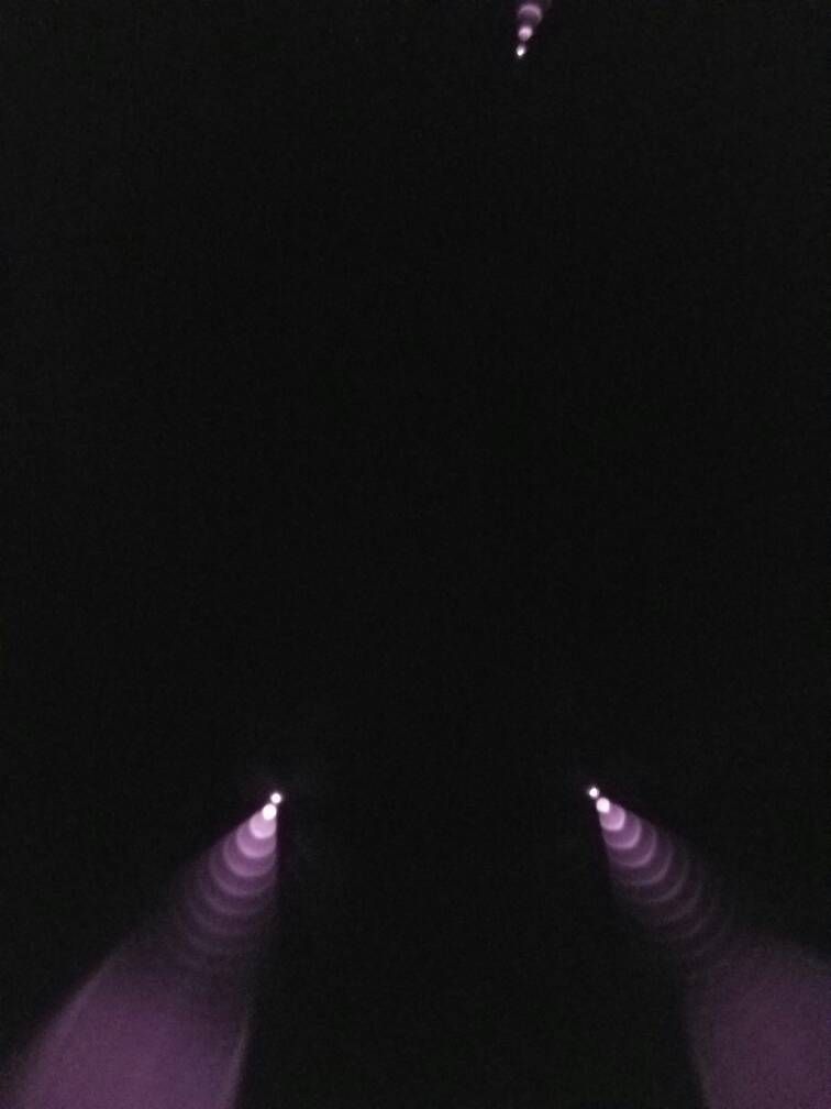

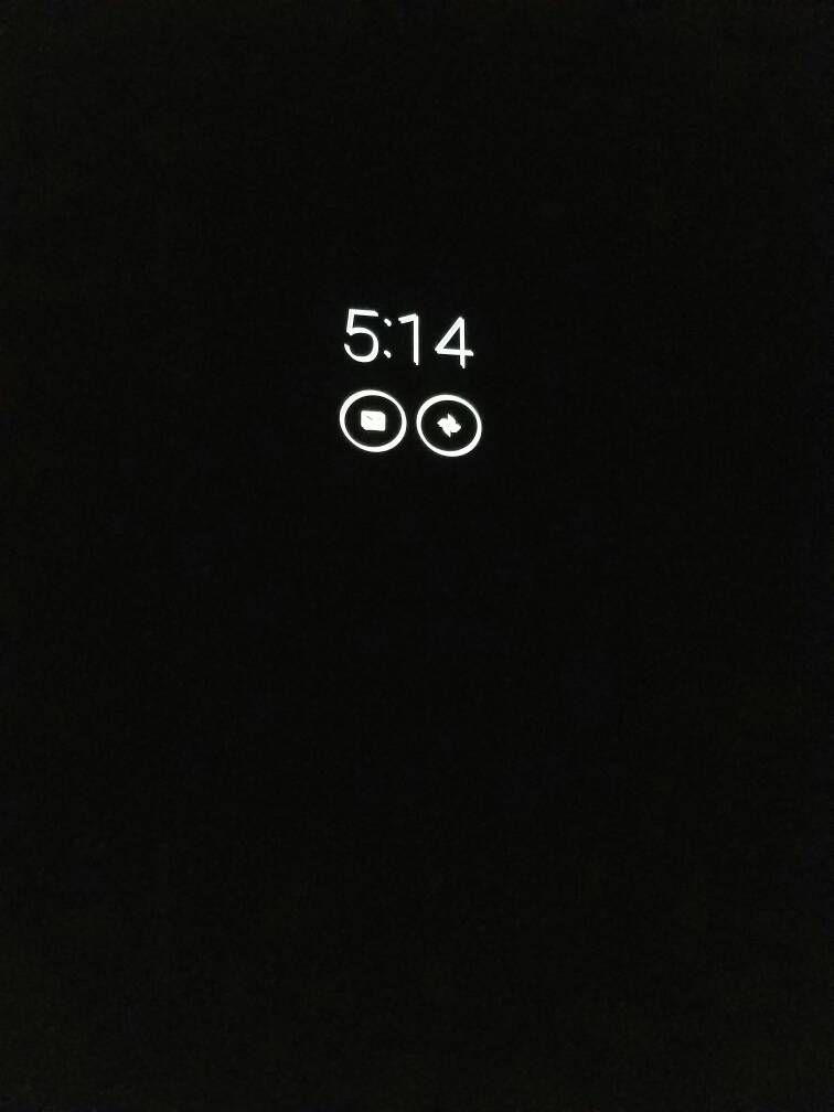

Below is a shot of one of the two infrared emitters on the bottom of my Turbo 2 and the one at top right which together with the detector are used to sense hand motion and trigger the active display. Then there are a couple more shots showing the different stages of operation.
You'll first see the three emitters, then just the lower left emitter in two different brightnesses, dim which is standby, and bright which is to achieve higher accuracy once any movement is detected. After it has confirmed movement it then turns on the active display and finally you'll see the active display and the infrared emitters are shut off during the display.
It was able to detect my hand moving in total darkness, the whole reason for this being so that in a dark room such as while sleeping, if you wake you can wave your hand in the general direction of your phone and it will light to show the clock and any outstanding notifications.
