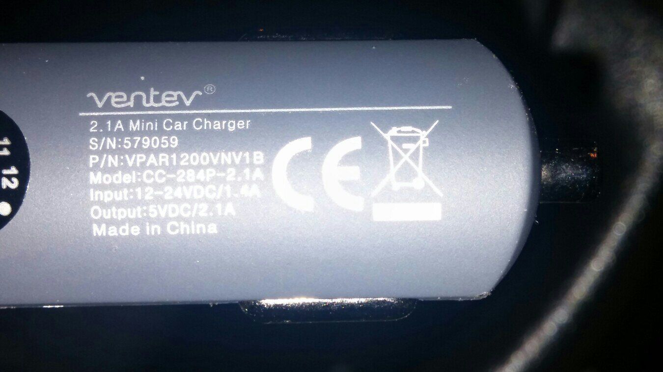

Have you been able to get any car chargers to work? Although most cars typically have the same output at the outlet, it's not uncommon for them to have low output.

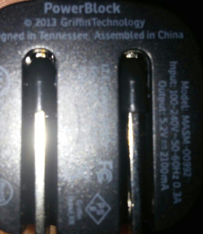

Idk about any information on the wire but it came with the power block.
