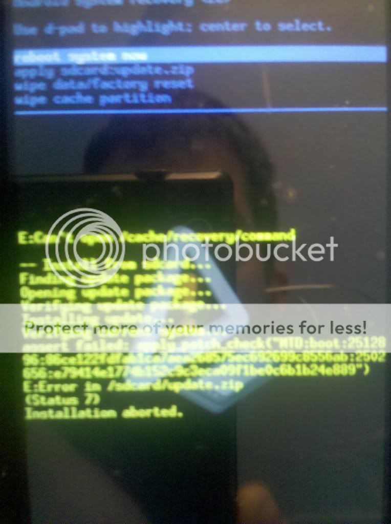

Still no 2.0.1
Here is the error
Something in that card is wrong. Didn't we have to change the ending on that file? Crap it's been so long I don't remember.

Same exact error. Grrrrr. Ok, should I try another SD card? I have my droid SD card, but my droid already has 2.01 on it.
Do I need to 'root' this droid first? Or doesn't this require that hack?
Well, switching SD cards didn't work?
Should I try wiping cache partition?

Oh, my bad. I was able to download the file, but during the installation of it, the phone spit out the same error :) Not updating. Guessing this Droid is a POS :)
Then do a factory wipe on the thing. Try it one more time and then take it back and get another one. This is crazy.

ok, crazy. Reset to factory. Tried the update, failed again. Logged in, reset up my phone. Enabled wireless again, and hit the sytem updates..............2.01 is downloading
So ya, its working now :)
Spoke to soon. The OTA update won't install either. Back to the store for his 3rd droid......
Well, if it says anything it proves there is no difference between the OTA and the one available on line. Third time will be a charm. :)
