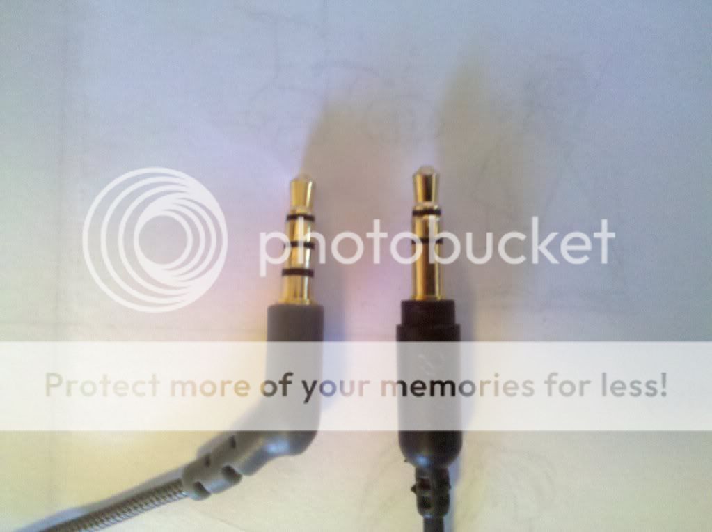

In an earlier post I mentioned that I have one set of headphones that always has this problem and some other sets of headphones that never have this problem. Here's a picture of their plugs:
The one on the left always has the unplug = no sound problem. The one on the right never has this problem. I have multiple headphones that DON'T have this problem, while only the one on the left in the picture has this problem.

The plug I was using that caused the problem looks like the one on the right! The headphones I use that have never caused this problem looks like the one of the left so I am not sure this is the issue. This still doesn't tell me if it is a hardware issue or software problem.
Darn well I was hoping everyone would just say that their "problem headphones" all had 3 little black rings instead of 2. I really don't know what those are. There's got to be some kind of variable here that's making the difference. It may not be something to do with the plug itself. It may just be something else about the headphones.
funny i just did the test and i have both the types of headphones. the ones that have been giving me problems is the one with 2 rings

I searched out and joined this forum just to find out about this problem. Only started after update on the 12th. Regular earbuds work fine. No issues with audio routing with regular earbuds, pull them out and it just works. However, If I use my set of iPhone headphones with the mic in the wire (and 4 rings on the plug), the audio never switches back to speaker unless I reboot the phone. Which is a major bummer, because with these headphones, you can squeeze the mic to toggle play/pause. Its really sweet. But they break my phone. I would call and make vzw replace it, but would the replacement work? Is everyone having this issue, or just a select few? Thanks guys.
