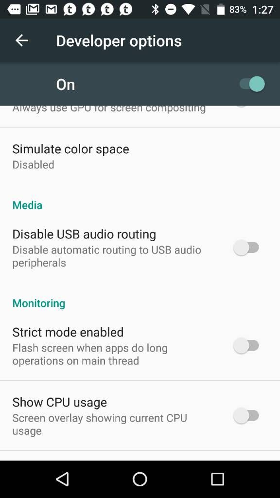

OK, looking at Developer Options I noticed another switch...
Look lower on the list scrolling down to the "Media" subheading and you should see the following.
It appears to default to on, where the "Disable automatic routing to USB audio peripherals" is set to off. Obviously it's a feature that the phone was designed to support.
