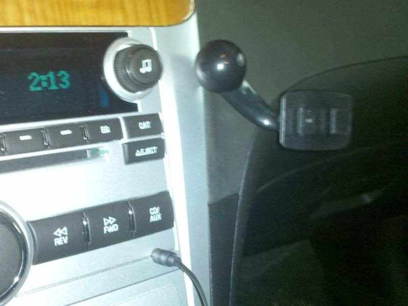

J-Stem Attachment
I use the J stem to keep the droid out away from the dash and further to the side so it doesnt block my radio controls.
The VSM mount with the J Stem extension arm and the plate that comes with the droid car mount (the socket in the previous picture) attached to the standard sized Nuvi ball and the collar tightened down. The cradle isn't snapped on so it can be seen. On your car the mount might be in a different spot. That black arm can be removed completely by simply pulling it off. Then all that is showing is a black ball about 1/4-1/2 inch off of the dash coming from between the joint of bezel/dash. That ball will take the socket from the droid car mount too as its the same size as the one at the end of the J Stem arm.
I was wondering how you like the J-Stem. I recently got my Pro.Fit mount and when trying to attach the J-Stem I had to use excessive force, so much that I was close to bending the metal plate. Does yours fit on smoothly? Is it possible I have a defective one? That is prior to actually installing the bracket in my car, but if I were try and attach or detach when the bracket is in I would torque the screws and bend or break something. I do not want to cause any damage to my Subi.
Any feedback would be appreciated.
It was definitely a tight fight. It got easier the 2nd and 3rd times. I wouldnt try installing it NOT mounted to the car. I had it in place and bolted down then applied force straight back from the ball. That way it wouldnt bend to the side but would push into the dash not against the screws. I found a twisting motion while pushing with the palm of my hand helped a great deal. The benefit is that once it's on, it's solid so it wont ever move because of gravity or the weight of whatever you have in the cradle. It is tough to get on but worth it. Take your time, push and twist, pause, push and twist, and it'll get on. If you dont have it attached and have nothing to push against it would be almost impossible.
