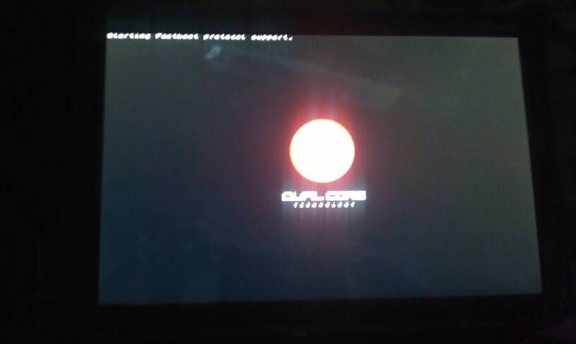

Are you booting to fastboot protocol mode and letting windows detect the device in that mode before trying to fastboot? What fastboot files are you using?
If booting to fastboot and windows has detected...what kind of errors are you getting? Try fast boot OEM unlock and let me know the results.....

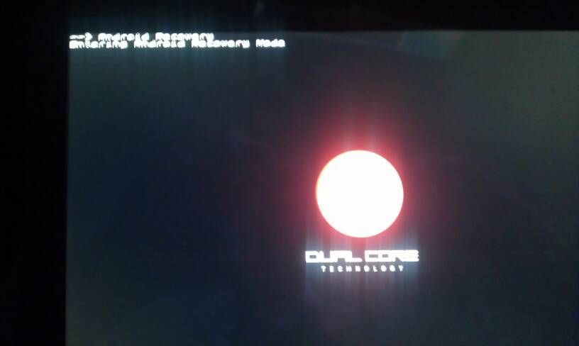

If it boots to the logo, it is repairable.

Absolutely booting to fastboot before attempting any cmds. When you say what fastboot files ya kinda list me...the SDK bundle?

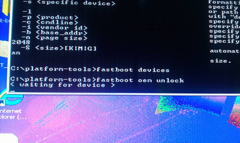

No errors. Just no response. I will try OEM unlock again right now .
Nothing.

That's one reason I suggested trying to flash the recovery.img file I linked in earlier an posting, it would allow you to install CM10.1 or EOS, etc...Roms if you can't find the stock one.
Try the fastboot OEM unlock and then the fastboot the recovery as stated above.

Ok. Btw...when stuck in waitingfor device what's the best way to cancel out?
Sent from my Inspire™ 4G With Beats Audio using Xparent BlueTapatalk 2
Very weird...
When you do the fastboot oem unlock, what are you getting on the Xoom's display? Since you are getting the "waiting on device", either your computer is not talking to the Xoom or the Xoom hasn't properly initialized the Fastboot protocol boot sequence.

If you get waiting for device you do not have the drivers loaded to talk to the Xoom over USB. You need to download and install them.
https://motorola-global-portal.custhelp.com/app/answers/detail/a_id/88481
If you can't get beyond the "waiting for device" then you may be stuck with a non-functioning device.....

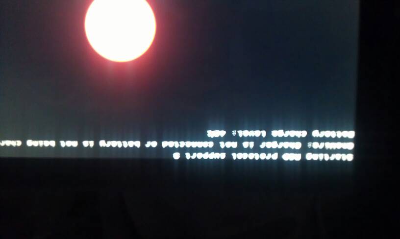

OK. Will give another go. One thing, I can't power off the Xoom. Only soft reboot. When I repeatededly tap down I never get a Fast boot RSD, only fast boot protocol. Is that abnormal?
Sent from my DROIDX using Xparent Pink Tapatalk 2
Fast boot protocol is where you want to be, the use the UP volume to select it. It's been about a year since I've owned a Xoom so details are fading and I have to rely on general memories of doing things.....so if you volume down and see Fastboot protocol, volume up to select it.
You want the device in fastboot protocol mode, you want your PC to have loaded the drivers for the device while it's in that mode ("device is ready to use") and then you want to fastboot each .img file. You have to be unlocked to do so, so start with
