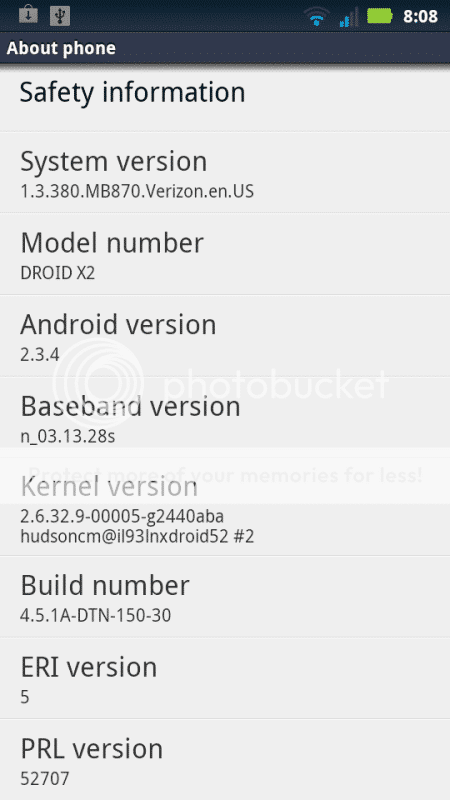

Just got my replacement phone from Verizon pre-built with the 418 OS. Honestly I thought I wouldn't be able to root, but I managed to SBF back to 2.3.4 using the DTN-150. Oddly enough it didn't factory-reset the phone like it normally does, and I was stuck in Roaming Mode until I did that myself. After the reset, re-activated my phone without issues, my previously 2.3.5 - 418 OS now back to 2.3.4 380. Everything seems to be working fine now.

Got froggy and SBFd to 2.3.4. with the DTN-150. All looks good at first glance. I'll update here if I find problems.
PS, I never deleted the data/cache either, so my info is still in tact, which is a major bonus
Edit: Everything looks good so far. Im now rooted and working on restoring apps from SD.
