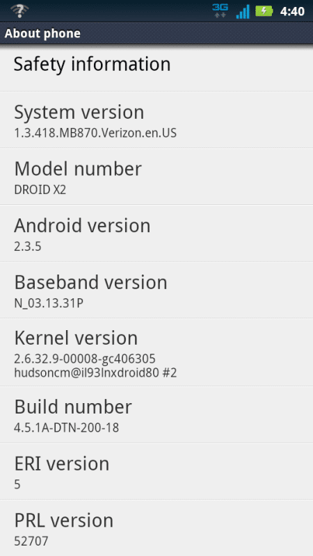

Just flashed the 418 2.3.5 with root from 2.3.4 using Voodoo. Great find, Jason.DROID!
Screen cap of end result with 418 2.3.5 : vvv
Update 2 : Unsure if anyone else had issues, but BusyBox didn't flash over when updating to 418. Could be just me. Tried to install and use Titanium Backup, didn't give the option to allow or deny usage from SU. Uninstalled, installed BusyBox off Market and reinstalled TB and works fine now.
Yeah, I had to manually copy the busybox binary to /system/bin with root and chmod 6755 to get it working again. Or if you use the Busybox installer, it does that for you. Otherwise, when you go to update the su binary in Superuser app, it will fail to update since busybox doesn't have the correct permissions set or isn't there at all.
