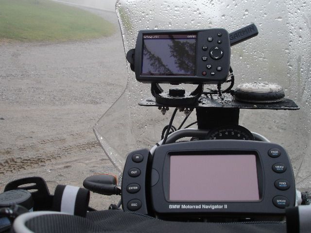

i have 8 gps units i use regularly.....
2 in each car
2 on my motorcycle
2 on my boat
yep.... i'm a nut for gps
they work everywhere
all over the country
all over the world
