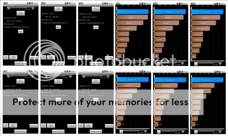

Here's some screens from my linpack and quadrant scores at 1000 (top row-taken consecutively) and 1300 (bottom row-taken over a 2 hour period) to give you guys a little teaser =) I used SetCPU to knock the processor back to 1000 just long enough to get the stock photos
top row: linpack - 13.565, 13.977, 14.335 quadrant - 1361, 1443, 1482
bottom row: linpack - 18.771, 19.206, 19.25 quadrant - 1799, 1839, 1864
hopefully this info ends up being helpful in some way, or at least sparks some food-for-thought... if anyone has any suggestions on what I could do/change to see some better results, I would love to hear them!
