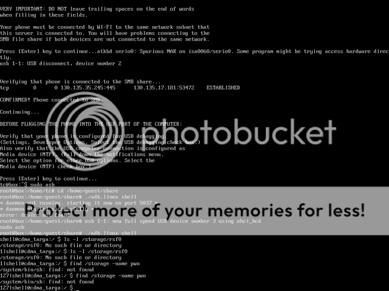

Both the terminal and the phone show connection. Within the phone I can actually see the shared files.
Seems to show a directory issue.

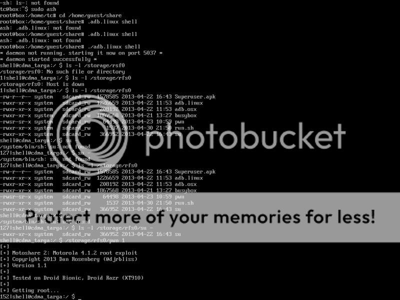

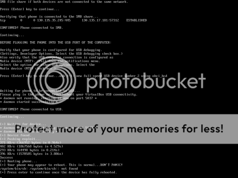

Hi All...I seem to have the same problem as the picture below. It states that /system/bin/sh not found. My phone never rebooted when it says "your phone may appear to reboot"
This is starting to make sense to me
having an issue being directed to the correct file
I helped it find the way

Hey Marty...I have gotten the network issues figured out, the jetpacks wont work, im at my parents and everything seems to work great.
The problem im having it stated success and notice phone will reboot and dont panic. But my phone isnt rebooting. I believe everything is set up correctly.
Any help is appreciated.
Seems like the same as the 2 posts above, is the path file the same as above in this case i see he as a razr

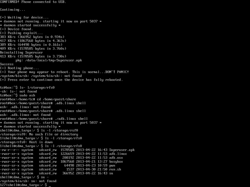

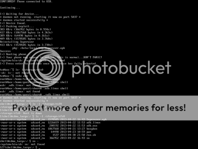

So you are right, this looks good. Can you type:
su -
and see if you get a root prompt?
The command it runs to root the phone once you get as far as you did is:
/storage/rfso/pwn 1
You can try running that manually and see what happens.
Well, I got it to work. Not sure if this matters, but here's what I did differently.
Instead of doing su - like you asked, I accidentally went past the point of putting in the previous commands and it went through with rooting the device.
When it restarted the first time, on the eye it vibrates 3 times. I always let it boot up before I did anything else, except this time I went ahead and hit enter to continue right after it vibrated three times and before the phone finished restarting. The phone restarted and now my phone is rooted.
Guess it was user error all along, thanks a lot OP :P
