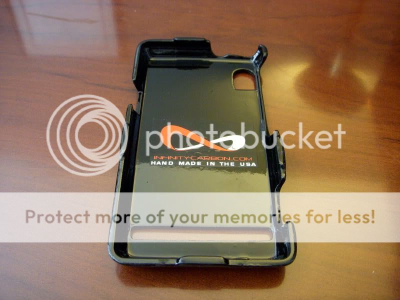

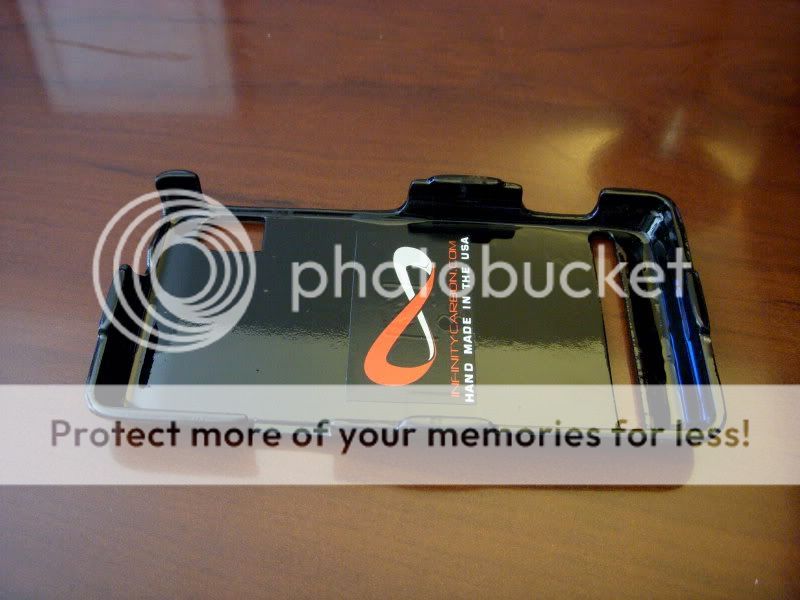

Its seems that you have just stepped foot into carbon fiber and you have a long way to go to get up to par with your Droid case. Everyone has already stated this. Its best you take care of your issues before picking out others. You keep saying you see flaw but yet to pick out any real concerns. As everyone knows, these are hand made by human beings not huge plastic molding machines in China. Your cases major flaws are the mounting points and structure. Tape will not dew. Anyone knows that tape will not stick well to flat black spray paint. Not to mention your cases are not even clear coated or as i know even buffed. Just my 2 cents.
Hayden
The flaws I could point out are also from a critical eye. That is the same as having a surgeon watching his/her son having surgery. Personally I see things with the case I don't like. But thats my opinion and mine alone. You also have to remember, my cases are the elimination cases that have caused the issues. My slideout cases I sent out 1 and that fit the phone flawless when it left here, im not sure what happened but we are looking into it. No case will be held on by tape. Deny it all you want but pressure fit does work. My red case has been pressure fit on my g1 for 6 months now and never slides off, moves or even budges after the abuse I give it. I'm not testing out a new method. This has been proven to work. I'm not a fan of the bubbled out tabs to hold the case in place.

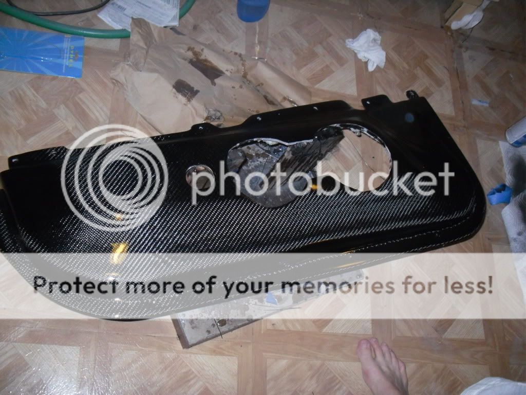

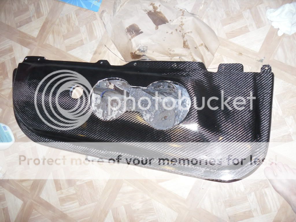

Maybe you haven't kept up on the thread but I've mentioned numerous times my cases are clear coated and buffed out. No case would have a mirror shine without that.
This finish would never be possible without a clear/buff
