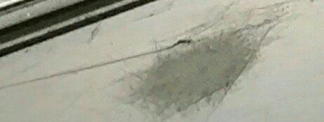

This is my home button after 3 month using it:
Perhaps you can see the black lines? This are some of the bigger one of my hairline cracks. The others smalller one are not visible in the picture. I don't know why. In the picture they are black, in reality they are "milky" white.

That looks terrible. Is the large frosted gray area in the middle a place where the front glass surface is gone, or is it just the polished surface that's been scuffed? I see the cracks but I'm wondering if they're just cracks on the finish and the glass is still intact.
Some hard finishes, including baked on ceramics will show hairline cracks due to having a different expansion coefficient than the substrate it's baked into, so as the glass underneath expands and contracts the ceramic is less flexible and cracks instead. This is very common ceramic pottery for example but also shows up on consumer electronics which use the same baked on finish technology.
Given that your finger is warm and the glass is vambient temperature for the most part, the temperature difference will cause tiny fluctuations in the glass due to expanding and contracting as you place on and remove your finger from it. Each time the mating surfaces of the crack are pressed together again as it contracts, microscopic fragments chipped away, and dirt combined with fine oils get between the surfaces accelerating the wear and making the cracks more visible over time. This could be the reason for the cracks. Also as mentioned before, our fingers are dirt magnets and or fingerprints hold microscopic abrasives that when rubbed onto surfaces cause those extremely fine scratches, and one time can wear the finish completely off.

What ever it was, glas or plastic, it is gone and Samsung, says that is not in warranty. It is strange and so obviously, that is not my fault.

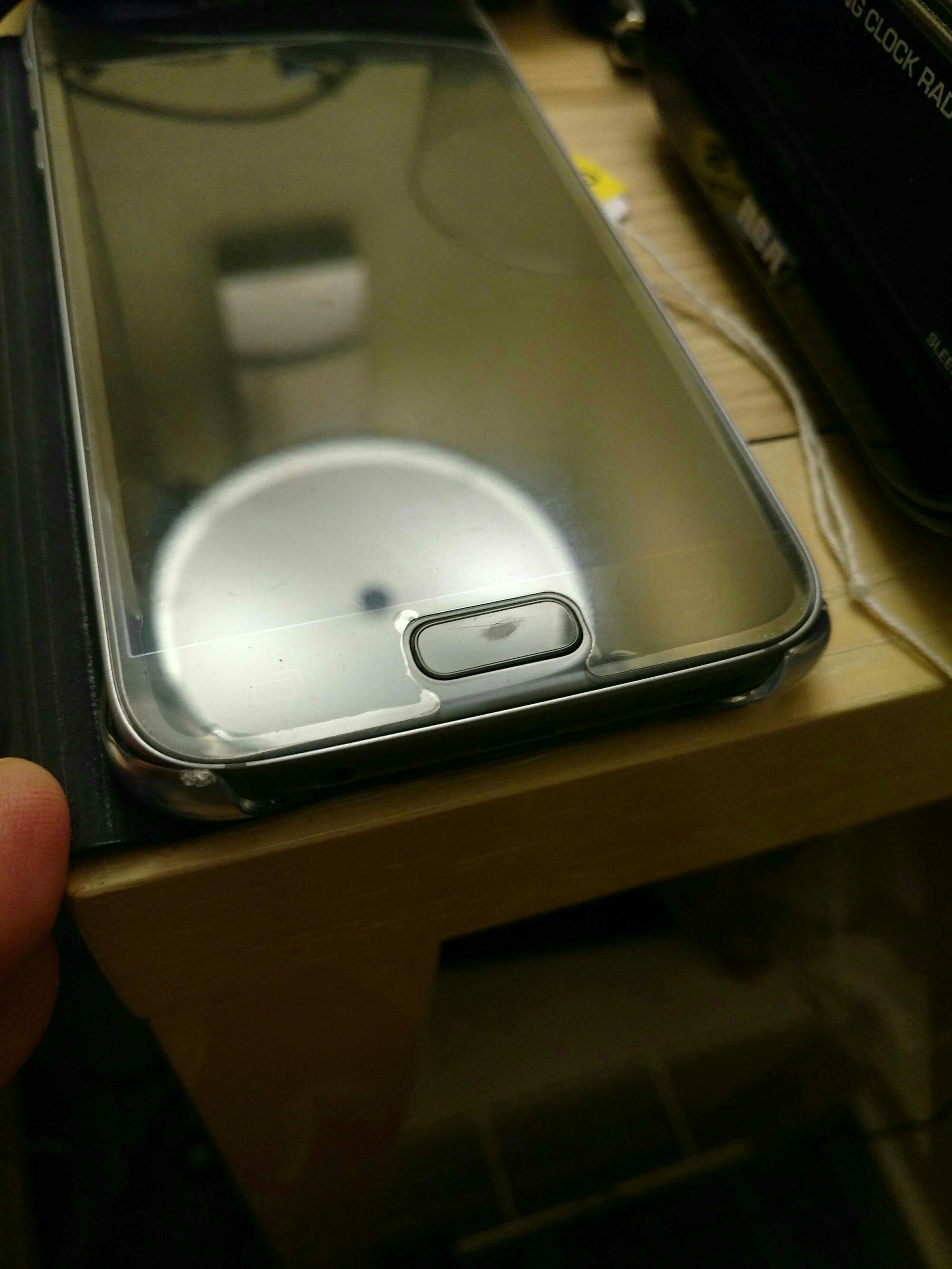

Please don't misunderstand... This is CERTAINLY unacceptable, and you shouldn't be to blame. What I was asking is, does the button "feel" like it's gouged out in that dark gray area or is it just a visible aspect?
For example, here's mine but it feels completely smooth...

And whatever the surface consists of, beneath a unscratched plastic surface becomes visible.
Since the surface is gone in the middle of the botton, it feels not smooth any longer
Looks like, that the surface is missing here too? Perhaps in a few days, you know what I'm talking about :-(
