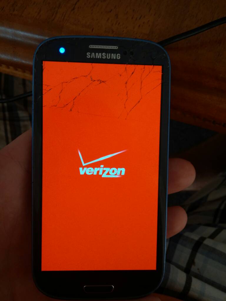

Stuck in boot loop
View attachment 72432Okay. I tried booting into recovery again and I got this. It still stays stuck on the verizon screen.

Okay my VZW S3 is on 4.4.2 can it be downgraded?

I'm not running. I get stuck on the verizon screen and it won't boot. It's this screen.
I'm still stuck on the verizon screen. I'd really like to get it fixed because my girlfriends iphone is crashing and she needs a new phone. Is there anything I can do to fix this? I'd really like to have her use it.

I just tried that. No luck. Still stuck on the verizon screen. It shouldn't be that hard to fix.
It can take up to 5 mins for the first startup...once you get it running, install the Verizon software assistant, then repair the phone using that software, it should fix all your problems. Message me @gmail on hangouts if you want real-time help!
So, KaosMaster helped me through it with google hangouts and now the phone is running perfect. He was online with me for about an hour. I'm really grateful he was able to help me. My phone was down for 7 months and he was able to get it up and running in no time.
