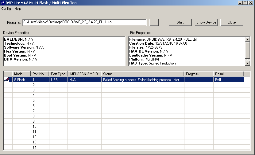

yea, those drivers aren't working. when i plug in my phone, i hear a noise through my computer, but when i open rsd lite my device doesn't show up... i've downloaded, and redownloaded the drivers, i must be doing something wrong
Did you install the app, then run the app and clean out your old drivers, install new ones, and then reboot the PC? That's the failsafe mode. Once you've done that make sure the phone is in bootloader before connecting to the computer. :)
alrighty. i downloaded everything again on a fresh laptop, and rsd lite picked up my phone. i selected that sbf you linked me to, then rsd lite did it's thing, then it got to a part where it just said flash failed. so now what do i do?
