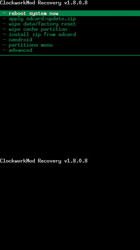

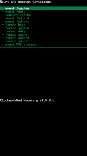

We will get you fixed up, worse come to worse flash sbf, but you dont have to. Go into cw recovery
Mount system
connect usb cord from phone to computer
Click usb mass storage
ur sdcard should open on ur computer
install 2.3.15 again and follow these steps.
2) Wipe Data
3) Wipe Cache
4) Select Mounts and Storage
5) Select Format System (ONLY DO THIS IF IT FAILS TO INSTALL THE FIRST TIME)
6) Select Mount System
7) Back out by pressing Power button
8) Select Install zip from sdcard
9) Select choose zip from sdcard
10) find and select this zip file
11) First Boot may take up to 5 minutes

So just do the install again from Clockwork recovery, this time wipe system...you'll be fine.
And in the future, always make backups! :)
the last option is mount usb storage
So I tried it again, and now my apps won't download from the Android Market like it did last time and my touch screen is a little effed up.. I lost my root also. So do I have to reroot in order to try this again?
I think I messed up the last time because I selected "mount /system" before I "format /system" and then had to do "mount /system" because it wasn't toggled to "unmount /system" before I did the install.
Yup - you gotta be rooted...root instructions are linked to from the page where you got the 2.3.15 download.
I would do a wipe of data/cache and /system (and follow commands carefully, step-by-step :) ).

Ok, I've tried many times getting to CW but am unable to. Here is what I'm doing:
  • Hold Power on and hod X key down.
  • I get the little triangle with yellow ! and the android.
  • I click on search and get the menu
  • I click OK since reboot is highlighted
  • Once it reboots and the M logo appears I pull battery which turns the phone off
  • I turn phone on and no CW, still stuck at M logo
One other note, when I get to the menu it says at the bottom in yellow :
E:Can't open /cache/recovery/command
I've looked at the post you linked before about replacing sbf and one other that is for linux How to flash a SBF via Linux! - xda-developers
I am not afraid to try those if that is my last resort. I will also continue to try getting to CW
thanks for your help!
I lost root as soon as the 2.3.15 installed and that made it so I could not get into cw. So cw is out. Boot into the normal recovery wipe data and cache then reboot. If that fails then just use sbf to fix it.
