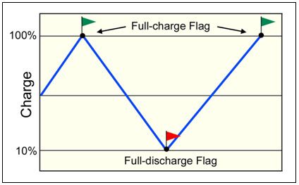

charge flag. Establishing these two markers allows SoC to be calculated by tracking the distance between the flags. For best results, calibrate a device in continuous use every three months or after 40 partial cycles. If the device applies a periodic deep discharge on its own accord, no additional calibration will be required. Figure 1 shows the full-discharge and full-charge flags
 | Figure 1: Full-discharge and full-charge flags set calibration
 Calibration occurs by applying a full charge, discharge and charge. This can be done in the equipment or with a battery analyzer as part of battery maintenance.
 Courtesy Cadex
