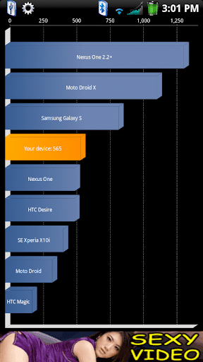

my new v5 benchmark running on stock speed.
