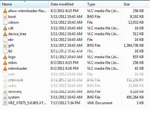

I haven't edited or deleted any thing. Where should I have the files?
Unzip the fxz an go into the folder (there will be to the main an sub 905 folder ie. 905---> 905----> files) cut all the files out of the sub folder an copy an past them in the main house of bionic folder where all his scripts an files are they should not be in any folder so when u open the house of bionic folder all the fxz files are there to an u can see all of them again they should not be in a folder
Is this correct?
Yes cut an paste all those files out of the fxz folder an back out of the folder an go into the house of bionic folder an past them
Ahh I see the issue, I downloaded the house of bionic file but I never unzipped it. I had another FXZ from another thread and was using that by accident. /noob off
